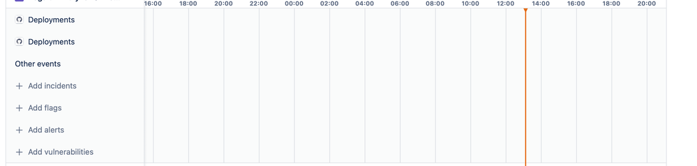

The issue is that Sentry doesn't show me anything at all or appear in the timeline, even when a test alert is sent as described in the documentation:

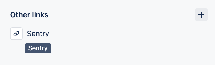

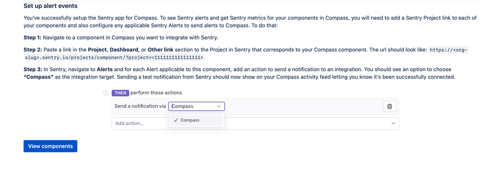

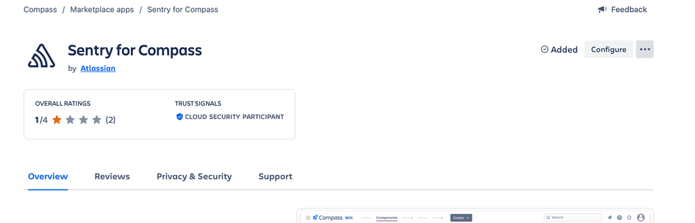

Configuration:
Screenshot 2025-11-24 at 13.05.51.pngScreenshot 2025-11-24 at 13.06.24.pngScreenshot 2025-11-24 at 13.06.46.png

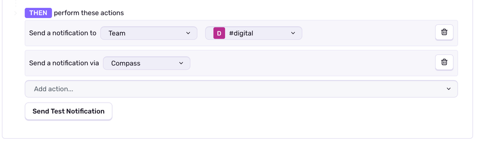

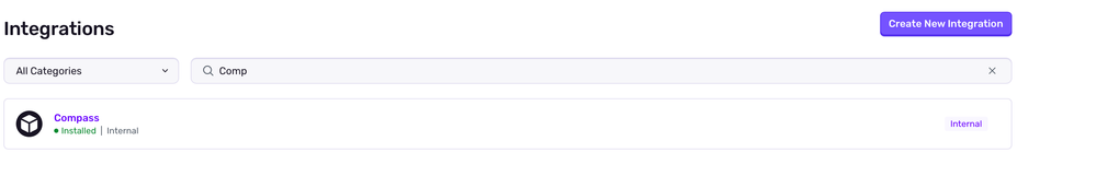

Sentry side config:
