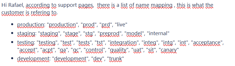

Blum_ Volker _Extern_
May 9, 2025
Rafael Ferreira
May 9, 2025
Any chance the customer can send us the link to the support page?
May 14, 2025
Hi Rafael, this is the link:
https://support.atlassian.com/compass/docs/integrate-compass-with-github/#GitHub-environment-name-mapping
And Atlassian Support already confirmed, that there is no way to change this.
Cheers
Volker
