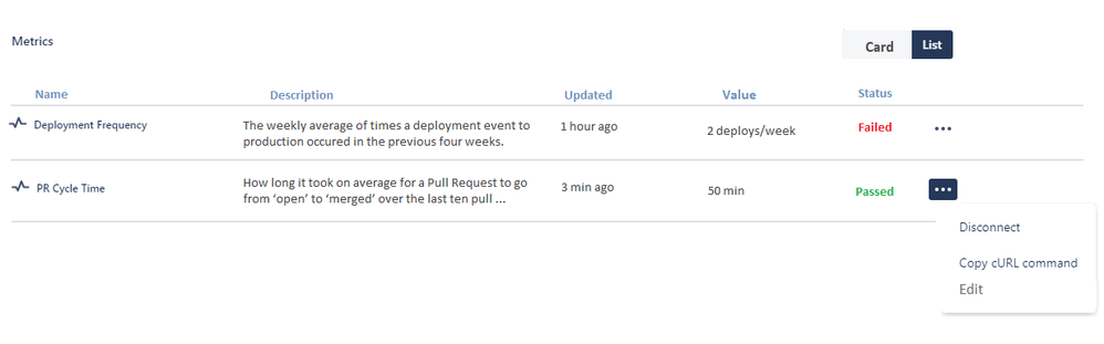

I'm not sure if this is the right place to suggest a UI feature request.
Hoping to have a list view option in the Metrics section inside the component under the Overview page.
Card and List views will suffice.
The reason is that when a component will have multiple metrics added, it will be difficult to see all the metrics because you have to scroll down the page.
Another feature would be to have a Status section where it will show if the metric passed/failed a scorecard.
An option to disconnect predefined metrics will be nice to have as well. Currently, this is not possible.
Is it also possible to allow metrics to accept a string value? Like a status Up/Down  or Succeeded/Failed.
Here's the sample UI.
