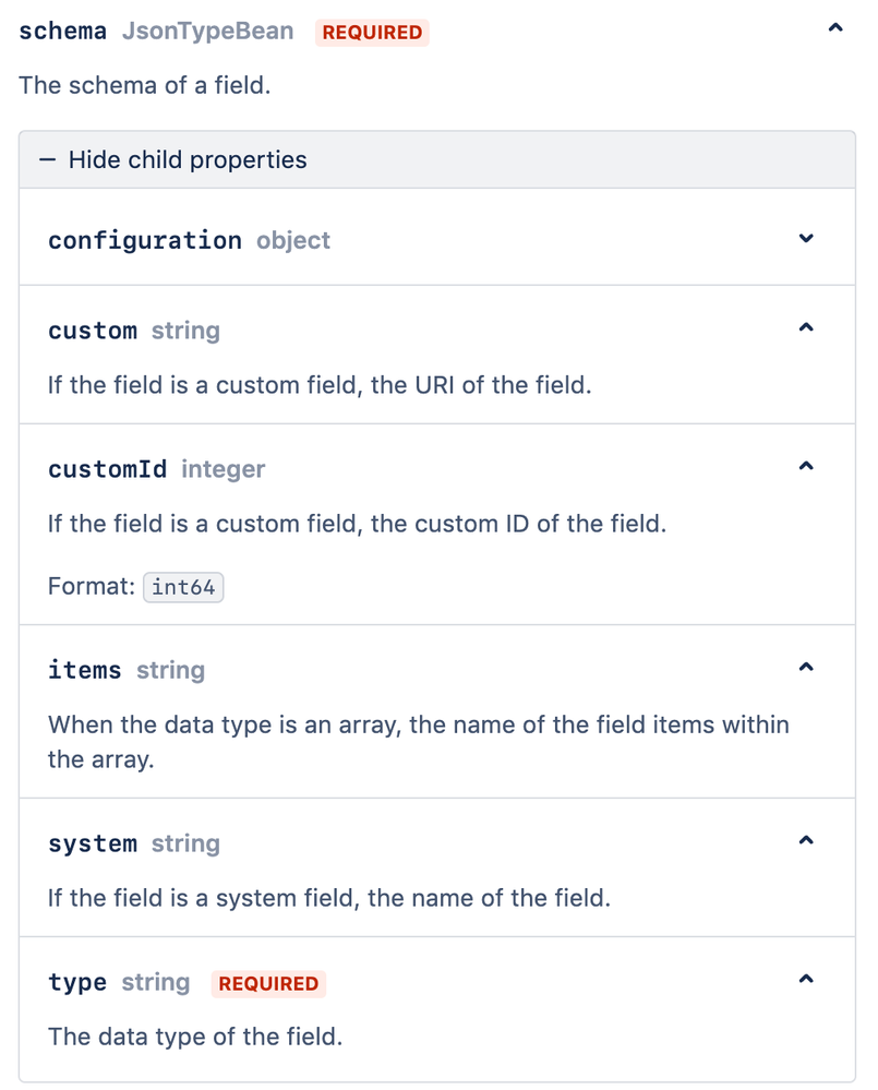

We have recently started populating the "configuration" element to one of the fields in Jira. You can see the "configuration" element already exists in the REST API schema that @Pavel Shkleinik shared above.
Is it the presence of this element that is causing the client code to fail?
It so, the client code should be able to handle this and ignore that element if that is not of interest to the consumer.

1. Something or somebody is fetching list of fields from Jira using https://developer.atlassian.com/cloud/jira/platform/rest/v3/api-group-issue-fields/#api-rest-api-3-field-search-get endpoint << no error here
2. The fields retrieved from the step #1 are fed to some 3rd party system << error happens here
The 3rd party system is not happy with the schema format (likely with the `custom` field since its value contains `:`). I don't see our documentation describing any formatting restrictions for the `custom` field:
I can see couple ways out of it:
- try to reach out 3rd party app support and negotiate updating schema validation rules
- consider removing offending field from the fields array before passing it to the 3rd party app
I doubt that we can change field's metadata on our side since chances are that number of internal systems and external customers are already relying on this value. On the positive note, we are actively working on replacing this field developed with https://developer.atlassian.com/platform/forge/manifest-reference/modules/jira-custom-field/ with native Jira field that will have metadata formatted as all other fields.
