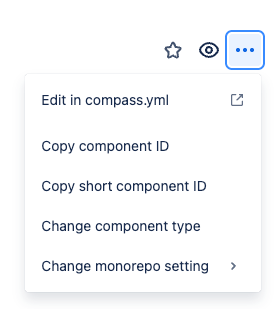

The component ID is available in `compass.yml` if you're using config-as-code, but it's also accessible in every individual component in the overview page, under the `...` menu.

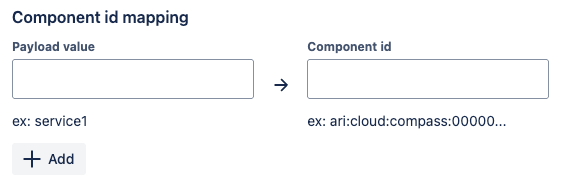

I understand this is something that would need to be added for every component, but you can set the mapping from any property in the payload to the related component ID during the original setup of the custom webhook itself.

The likelihood that I'll ever do manual mapping/copy-paste of Compass Ids is pretty much zero. If we had so few components that this was a useful approach, then a product such as Compass doesn't add much value in the first place.
