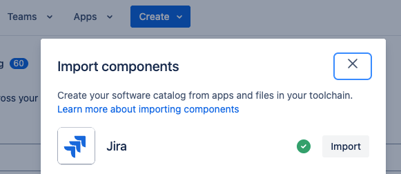

You can also keep adding new connected Compass Components to your site using the Create > Import Components > Jira > Import option of your Compass instance.
