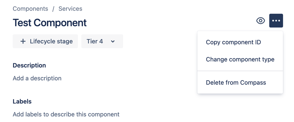

// this should be a component ARI which you can get by clicking the ... on a component overview page and clicking Copy Component ID
