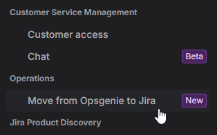

Potentially, you could also check Settings > Jira apps > Move from Opsgenie to Jira but that might be a bit different thing.
