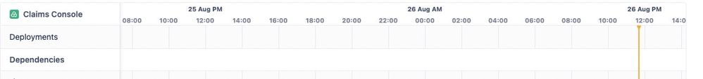

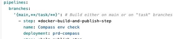

We are trying to integrate Compass as a dashboard to observe different environments for our builds. I had added the deployment and name tags to the bitbucket-pipeline.yml file under the branches in the repository for one of our applicationsA16CE28E-72BC-48A0-8AEE-BD980AE047CB_4_5005_c.jpeg and once the build had succeed, nothing populated in the activity tab.
Was wondering if I could get some help with the environment integration.

Hey @Isaac Petersen 👋 It's Dave with the Compass product team. Currently, Compass filters out deployments that aren't targeting the `production` environment.
So just update the `deployment` line in your script to read:
deployment: production
And you should be all set!
Sarah Bland
August 29, 2022
Hi @Isaac Petersen ! Sarah here from the Compass engineering team. A quick tweak to what Dave mentioned above - in order for deployments events to be picked up, the name of the environment does not need to be "production", but the environment needs to be of type production. More information about environment types in Bitbucket pipelines can be found here: https://support.atlassian.com/bitbucket-cloud/docs/set-up-and-monitor-deployments/ under "Step 1: Define your environments".
