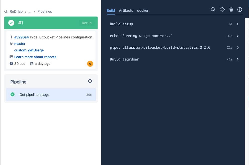

I run the pipeline from the bitbucket web page by clicking the "run pipeline" button at the top of screen.
this does not give me access to a terminal or to command prompt (or if it does, I don't know how to access them).
Without terminal access, I do not see the output to stdout, nor do I know how to access the file, since I don't know what filesystem the file is on or how to access that file system.
What filesystem does the pipeline run in? How do I access the file system?
The full pipeline is (the cut/paste destroyed the yaml indents)
Deleted user
December 7, 2020
Ok, I figured it out. If I look at the output of the build log, I can see that the pipe: atlassian/bitbucket-build-statistics ran for 21s. Clicking the little arrow on the far right opens the log output. The needed data is there, at the end of the log output.
