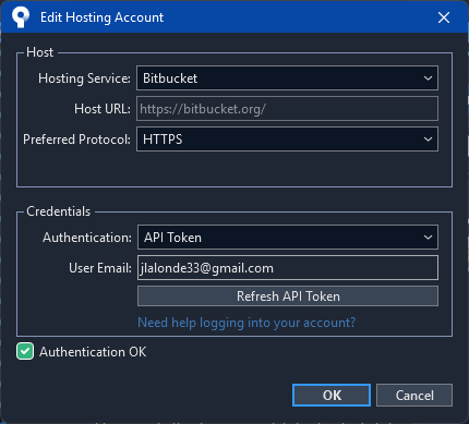

My authentication setup in SourceTree was set as specified in :
https://support.atlassian.com/bitbucket-cloud/docs/add-an-api-token-to-sourcetree-or-another-application/
1V8igWz
Refreshing the API Token was successful.
7mn4jrU
However, SourceTree still produces the error "App passwords are deprecated and must be replaced with API tokens". It is as if the new account's token was not used by my repo.

I'm not sure if this can be related, but if I remember well, when I update the account details in SourceTree, my username was changed from "jlalonde33" (username only) to "jlalonde33@gmail.com" (username and GMail domain).

Hi Jean, that 410 is Bitbucket saying it got an app password, so what you refreshed isn't reaching it. A bad or under-scoped token gives 401, so that isn't it.
Your gmail hunch is worth pulling on. Sourcetree stores credentials per identity as USERNAME@DOMAIN, and only uses the account ones when the remote URL carries no username. Yours pins JLalonde33. So git may still be looking up that old entry, while your refresh landed under jlalonde33@gmail.com.

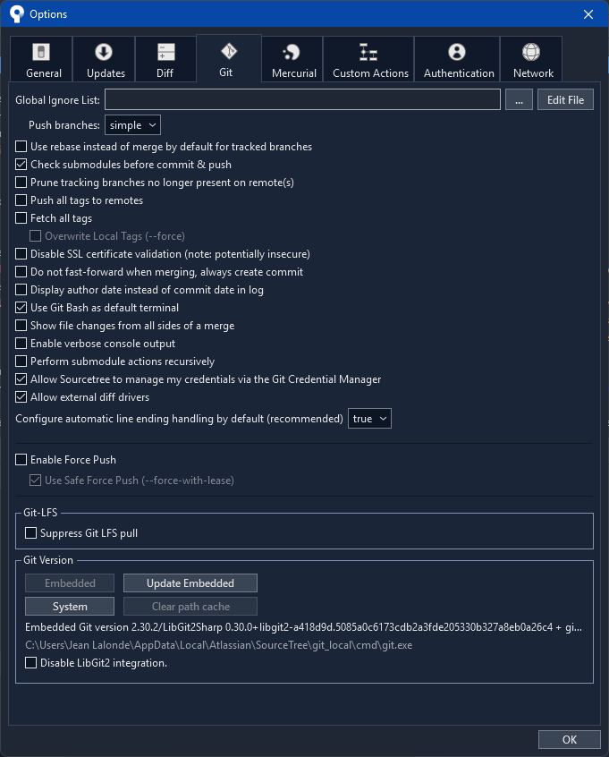

Check Tools > Options > Git and see which embedded Git you're on. Richard Brookes-Tee, also on 3.4.31, cleared Windows Credentials, cleared Sourcetree and revoked his app passwords with no effect, then found his sitting on 2.2x. Updating it, choosing "Manager", then taking the web/OAuth side of the new prompt, since the API Token side didn't stick for him: his write-up

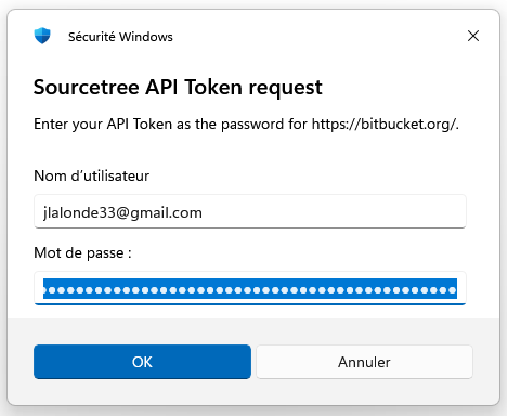

I think it made it.
Before:
 wXNrMqo
After:
 qRVJro9
A popup prompted me to select "Manager" a few times. I selected "Always use...". I won't push in the next days. Let's see later if everything remains OK.
