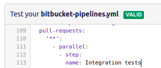

Hi guys, I have this part of my pipeline:
# omitted
pipelines:
pull-requests:
- parallel: # this point
# omitted
Is it possible to run parallel tests on this part? The pipeline is valid but it doesn't work when I run it.
Valid pipeline:
Error to execute:
Thanks in advance.

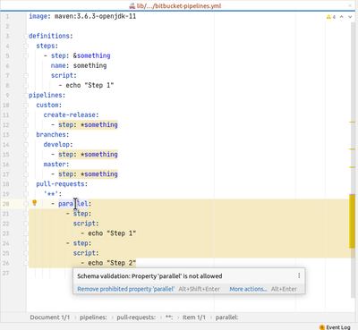

ktomk
October 2, 2020
Hi @Claudenir Machado , welcome to the Atlassian Community.
The bitbucket-pipelines.yaml online validation (the online tool in your screenshot) does not always show the whole picture.
In your case the configuration error message is mandatory highlighting the error.
The error is not a big one, the `name:` property needs to be indented once more into the `step:` property turning it into an actual object (instead being null).
That is meant by the error message that the step section is empty (it actually is).
Same is for `script:` in your following YAML. Just indent this all once more what belongs into `step:` and it should work.

If you're using and editor or IDE to edit the files, check for JSON Schema support, despite the file is YAML, JSON Schemas also apply to it (YAML has a JSON representation). Editors / IDEs normally highlight then the erroneous places more visually so errors are easier to catch.
bitbucket-pipelines.yml validation inside IntelliJ based IDE (here Phpstorm), works with JSON schema validation via https://www.schemastore.org/json/ .

Hi Claudenir,
Thank you for your reply and example.
As @ktomk correctly pointed out, this looks to be an issue with indentation.
Everything nested under - step: (like name:, script:) should have 4 spaces of indentation, instead of 2. (The commands under script: should still have 2 spaces)
Extra 2 spaces should be added for name:, script: in the definitions, and also in script: in the pull requests steps.
The reason that the validator doesn't show any errors is due to a bug when the yml files uses anchors:
Does this work for you with these indentation changes?
