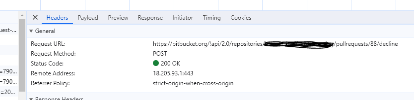

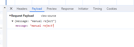

Working solution
it appears that /decline api is able to accept reason for decline - it is not obvious from documentation, actually it is misleading, but if you open dev tools and manually decline with the reason string, you can see
and with that the PowerShell script is
$workspace       = 'your company name'
$repo_slug = 'your repo name'
$pull_request_id = 77 # pr number
$reason = 'your reason to decline' #plain text
declineUrl = "https://api.bitbucket.org/2.0/repositories/$workspace/$repo_slug/pullrequests/$pull_request_id/decline"
$reasonBody = '{ "message": "reason" }'.Replace('reason', $reason)
Invoke-RestMethod -Method Post -Body $reasonBody -ContentType 'application/json' -Uri $declineUrl -Headers $headersCloud
