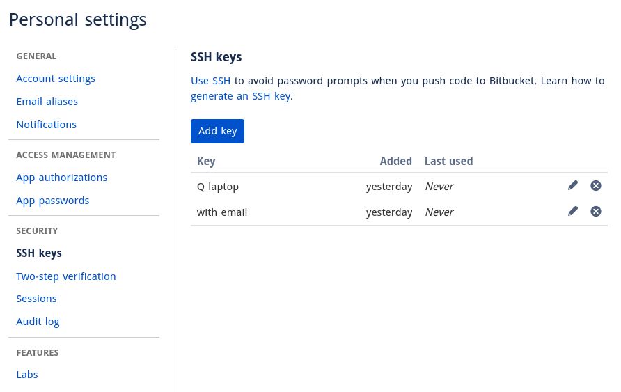

I have two ssh keys in my .ssh directory, which I would both expect to work as I have added them in the browser. (See screenshot) These are the keys that are shown in the logs on line 133 and 135 ("Offering public key: ")
