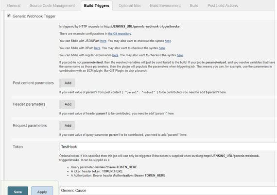

Hi,
For me also Bitbucket cloud webhooks for Jenkins is not working.
As an alternate use Jenkins's Generic Webhook Trigger Plugin.
Currently, This Generic hook is working fine.
Based on you Jenkins URL, use Generic Webhook URL in Bitbucket like below,
https://jenkinsci.sara.com/generic-webhook-trigger/invoke?token=TestHook
Thanks!
Sangeeth
thanks
you saved my day!!!
worked like a charm
