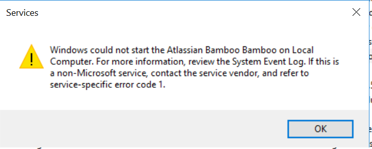

Tried to follow all of the tips in the knowledge base and it will not run as a service. I get service error code -1
Can you help?

Could you please share the KB article you followed? We are also interested in the error message/screenshot you get when you try to start as a service.
Were you able to start Bamboo via <bamboo-install>/bin/start-bamboo.bat?

Gus Minor
February 27, 2019
Here are the things I tried to follow. My SEN as submitted in the ticket is SEN-13415218
https://confluence.atlassian.com/bamkb/running-bamboo-as-a-windows-service-troubleshooting-guide-420973231.html
https://community.atlassian.com/t5/Bamboo-questions/Can-t-start-Bamboo-as-a-Windows-service/qaq-p/33218
https://community.atlassian.com/t5/Bamboo-questions/Bamboo-service-does-not-start-error-code-1/qaq-p/647545
I can run it if I manually start the BambooConsole.bat but that is the only way it will run.
When I try to install the service then run it I get the following.

I found the issue and was able to get it going. I had to update some lines in the service.bat file to make sure it refers to the proper Java JDK. I found this via a third party suggestion.
