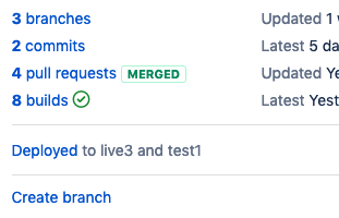

- Our Bamboo can correctly see which issues a release relates to
- Our Jira can correctly see the deployments an issue has been deployed to (see where it says "Deployed to ...").

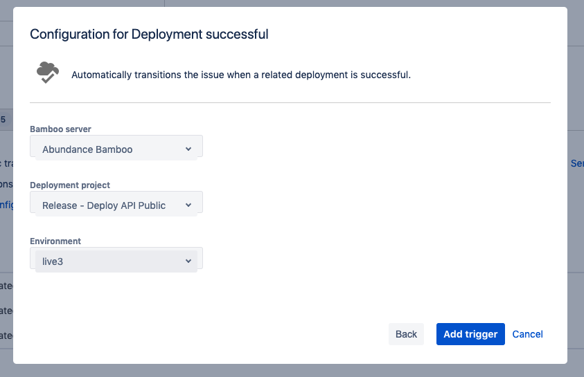

I then edit the transition for that step and added triggers like this:
1. Add trigger
2. Choose "Deployment successful"
3. The form appears and has correctly found my Bamboo server and release projects.
I repeat this to add 3 triggers (we have 3 different Deployment projects for 3 different components of our system).
But nothing happens... The Deployment suceeds and in Bamboo I can see it has has listed the right Jira issue under "Issues"
But the issue never gets transitioned to "Released" in Jira.

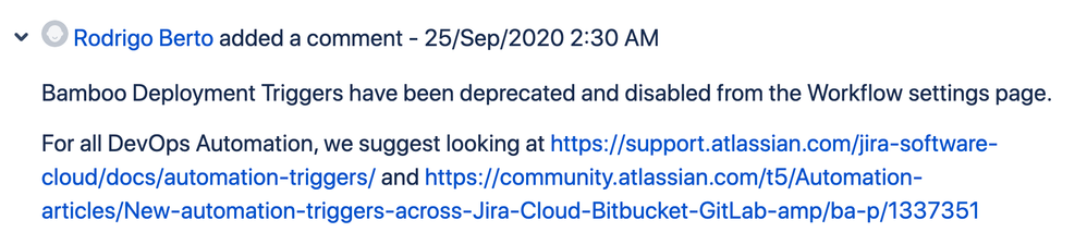

Tobias F
December 21, 2020
Well, it seems Bamboo deployment triggers have been deprecated. https://jira.atlassian.com/browse/JSWCLOUD-16754Screen Shot 2020-12-21 at 11.05.09 AM.png
