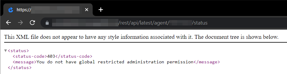

As an end user, I'd been hoping to use the Bamboo REST API for interrogating the status for some of my Bamboo agents (connected to a Bamboo Server instance; v6.10.4 build 61009), but I'm getting a 403 error; "You do not have global restricted administration permission".
This doesn't seem to match with the reference docs for that version: https://docs.atlassian.com/atlassian-bamboo/REST/6.10.4/#d2e806
Specifically looking at /agent/{agentId}/status interface, I would assume it should be a 401 error, not a 403, if I don't have permission.
Our server admin indicated he believed it required admin privileges to view agent status; is that accurate? I'm hoping we have something misconfigured, and you just need to be signed in.
If admin rights are required, is that something you would consider changing? As an end user, I would that that monitoring the status for my associated agents in an enterprise environment shouldn't require elevated permissions. Especially for agents that are dedicated to my project.

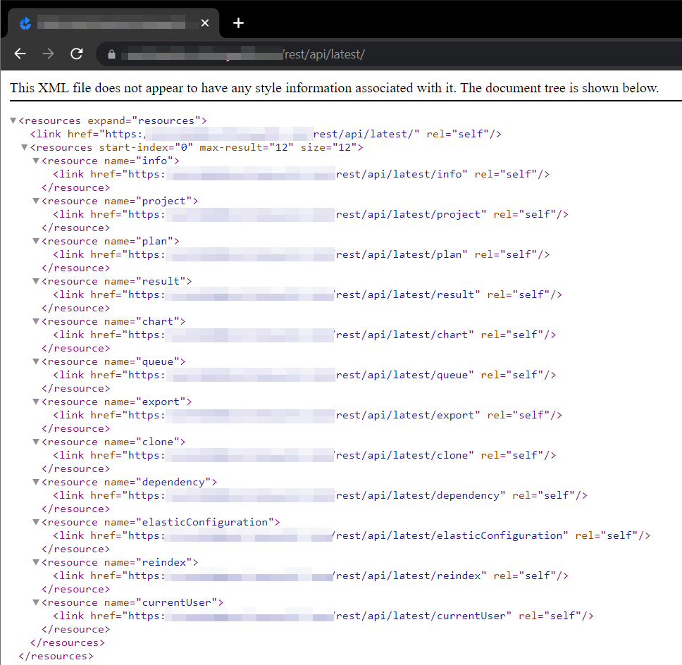

I can confirm that other REST API endpoints work to some degree:

I can confirm that my credentials are not an issue, as other REST endpoints (including ones that require my specific user's permissions to view) function correctly within the same session, and when run from an alternate tool (different browser, and using cURL).
Please note that the error code is a 403, not a 401. I confirmed the status code presented in the browser matches the status code sent in the header:
$ curl --head -H "Authorization: Bearer <token>" https://<bamboo_url>/rest/api/latest/agent/<agent_id>/status
HTTP/1.1 403
Date: Wed, 09 Jun 2021 14:02:35 GMT
Server: Apache/2.4.46 (Unix) OpenSSL/1.1.1i
X-ASEN: SEN-9325228
X-Frame-Options: SAMEORIGIN
X-Content-Type-Options: nosniff
Cache-Control: no-store
X-Seraph-LoginReason: OK
Cache-Control: no-transform
Content-Type: application/json;charset=ISO-8859-1
Content-Language: en-US
Transfer-Encoding: chunked
Set-Cookie: JSESSIONID=<session_id>; Path=/; HttpOnly
 Here's the response:
$ curl -H "Authorization: Bearer <token>" https://<bamboo_url>/rest/api/latest/agent/<agent_id>/status
{"message":"You do not have global restricted administration permission","status-code":403}
Per the Atlassian Bamboo REST API reference material, this interface should not be able to return a 403 error, which is why I'm wondering if our server is misconfigured to restrict permissions.
I can also confirm the system recognizes my credentials
$ curl --head -H "Authorization: Bearer <token>" https://<bamboo_url>/rest/api/latest/currentUser.json
HTTP/1.1 200
Date: Wed, 09 Jun 2021 14:10:04 GMT
X-ASEN: SEN-9325228
$ curl -H "Authorization: Bearer <token>" https://<bamboo_url>/rest/api/latest/currentUser.json
{"name":"<id>","fullName":"Daniel Bernard","email":"<email>"}
And similarly for other permission-protected endpoints:
$ curl -H "Authorization: Bearer <token>" https://<bamboo_url>/rest/api/latest/permissions/project/plan/<project>/users
{<valid_response>}
$ curl --head -H "Authorization: Bearer <token>" https://<bamboo_url>/rest/api/latest/permissions/project/plan/<project>/users
HTTP/1.1 200
Date: Wed, 09 Jun 2021 14:35:50 GMT
X-ASEN: SEN-9325228
