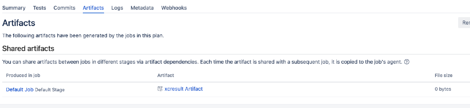

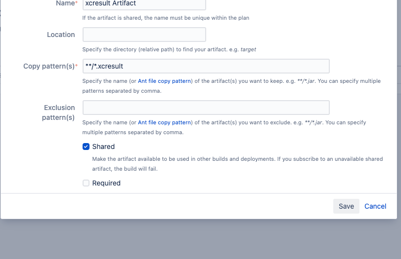

As far as I am aware Bamboo does not have any limitation on file types as Artifacts, just for testing purpose I defined a artifact and using generated a test file using touch abcd.xcresult in my script task, I am able to see this file in the artifacts tab, below is my artifact definition.
You can see my artifact was created and I am able to download it
Can you try the above artifact definition and let me know the results.

Hi Shashank Kumar ,
I have tried this way of declaration and couple of other ways too that I could think of but it didn't work out for me.

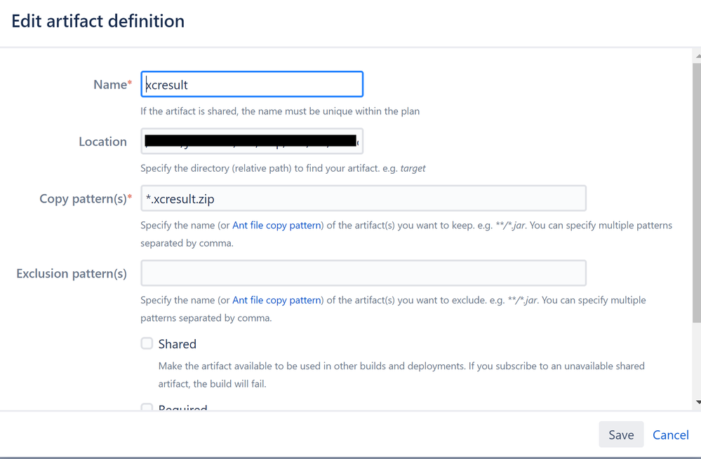

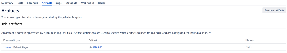

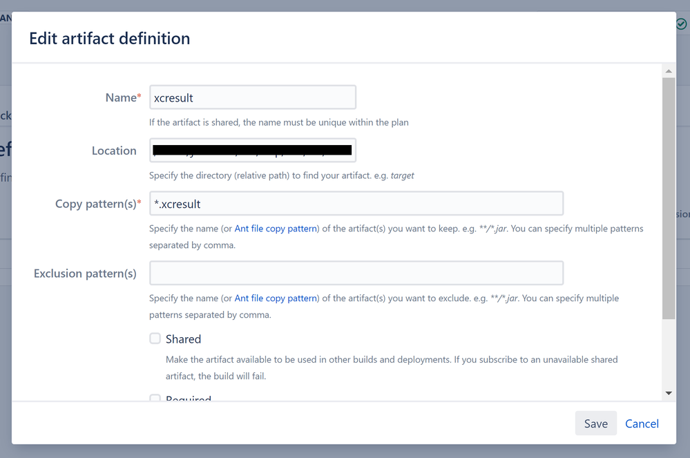

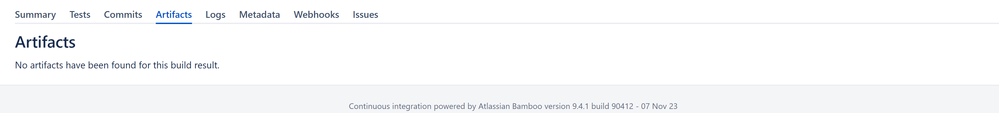

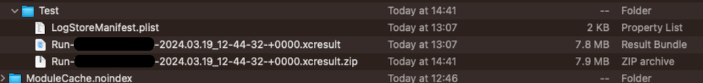

Please see the attached pictures, for .xcresult.zip file, I am able to get artifact attachment.
While when I change the file pattern to .xcresult file, I am not getting any attachments.

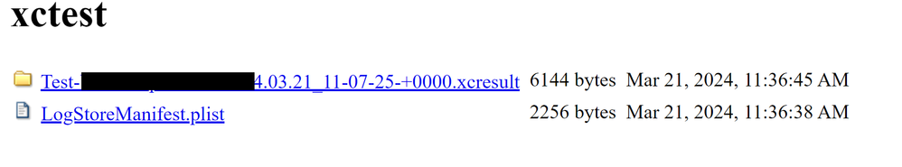

Both files are in the same source directory as in the screenshot.
I didnt add any exclude pattern.
File path is also same only pattern is different.

I got to know what the problem was. '.xcresult' file is of type result bundle. Basically it;s treated as a folder structure. So I was not able to pick it up as file. I changed the file pattern to **/*.* and it was picked up along with other files.
