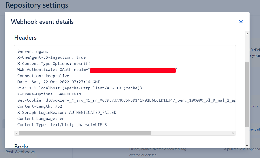

@Eduardo Alvarenga the response is:
HTTP Status 401 – Unauthorized
The request has not been applied because it lacks valid authentication credentials for the target resource.

Rafael Costa
October 22, 2022
I'm trying create a webhook from Bitbucket to Bamboo. Actually I do it with same user from Jira to Bamboo without problems. But from Bitbucket to Bamboo I'm receiving this error.
My main question is: How do I set an webhook from Bitbucket's repository to call a Bamboo plan when a pull request when a Pull Request is approved?
Eduardo Alvarenga
October 22, 2022
Hello @Rafael Costa
The Bamboo REST API will only accept Basic authorization or a Personal Access Token. It will not work with OAuth.
We advise you to use the recommended notification method via native integration. When using Application Link integration, Bitbucket will automatically notify Bamboo when any repository changes. You need to have an Application link between Bamboo and Bitbucket set, and the repository type in Bamboo needs to be either Bitbucket Server or Bitbucket Cloud (available on Bamboo 9).
On Bamboo, your Plan must have an enabled "Bitbucket Repository Trigger". Then once the repository changes, Bamboo will be notified and will initiate a change detection task on the repository and in case of changes, trigger a build.

Rafael Costa
October 27, 2022
Thanks @Eduardo Alvarenga , I did it and worked!!!
