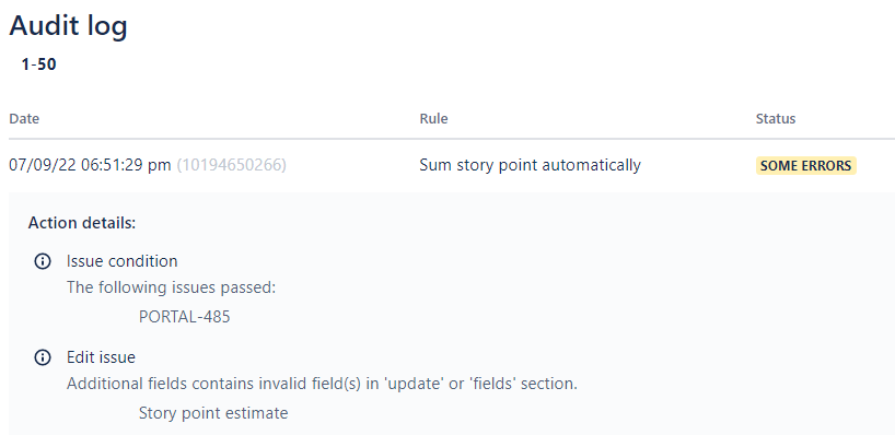

i want to sum story points with automation in jira, and made this logic.
Action details:
Issue condition
The following issues passed:
PORTAL-475
Edit issue
Additional fields contains invalid field(s) in 'update' or 'fields' section.
Story point estimate
i checked it, there is no "story point estimate" field for user story and task backend, but there is for web frontend.  but it's ok for subtaks. which field i should use?
how can i fix it ? many thanks

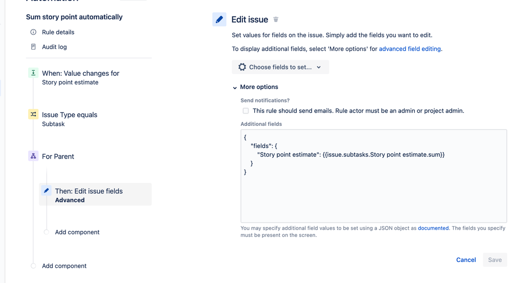

what I want to do is to sum the story points of all subtasks automatically for one user story or task. and I created a new automation rule for it. and I activated the "story points" for estimation in the project setting=>feature.
The issue comes in the 3rd step "Edit issue fields", I can't find the "Story point estimate" in the dropdown list. and so, the rule can't run well.

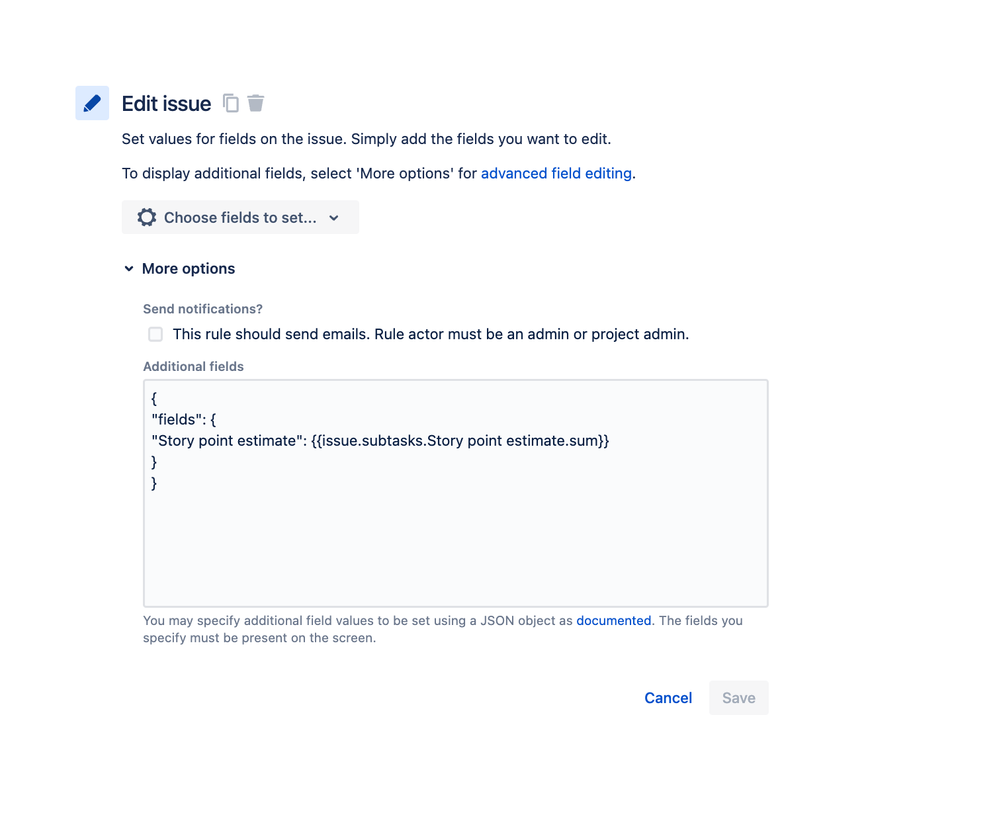

Guess I´ve got the problem already:
There is a different field for the estimation in team-managed and company-managed projects.

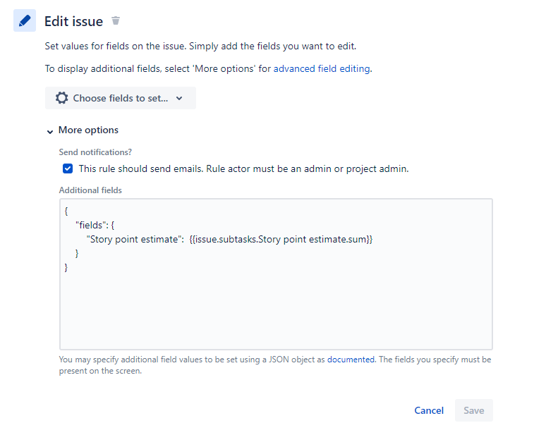

Within team-managed projects this field is called "Story point estimation". Unfortunately (as you already pointed out correctly) this cannot be chosen in the dropdown field so the advanced edit function via JSON needs to be used. I tried this in my environment and it worked (see the screenshot):
I´ll add this here as text so you can copy this directly:
"fields": {
"Story point estimate": {{issue.subtasks.Story point estimate.sum}}
Please give it a shot and let me know if it works.

i've tried, but it doesn't work for me. act log attached.

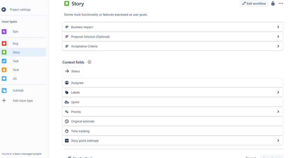

Which issue type is the issue "PORTAL-485" that should be edited in your audit log screenshot?

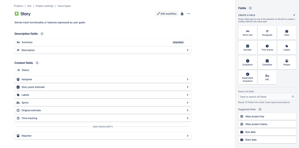

From your former screenshot of issue types settings I can see that there is a field "Story point estimate" in issue type "Story".

  1. the edit issue field action screenshotScreen Shot 2022-09-07 at 20.21.53.png
  2. the issue type of "portal-485" is a subtask, you can see it in the screenshotScreen Shot 2022-09-07 at 20.23.37.png
I have no idea why it doesn't work for me. I need your help!
Stefan Salzl
September 7, 2022
Ok. Thanks for your input. The edit issue fields action looks different now to your initial post as it now only shows "advanced" option (formerly: Story Points).

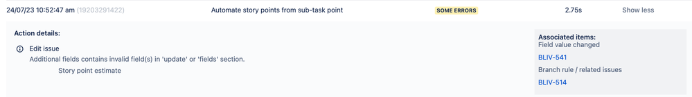

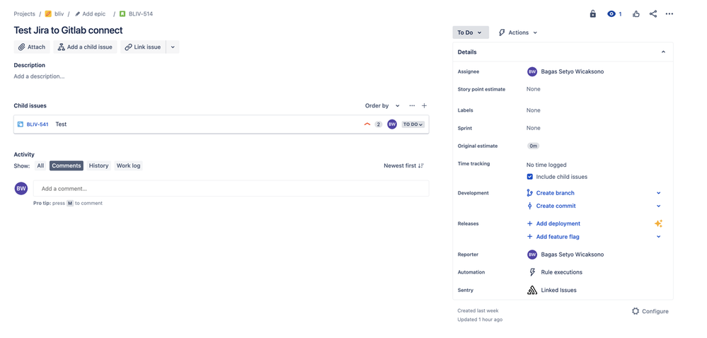

Bagas Setyo Wicaksono
July 23, 2023
I have a similar problem, following your steps. After I tried your suggestion before, it still shows like this.Screenshot 2023-07-24 at 10.54.50.pngScreenshot 2023-07-24 at 10.54.59.pngScreenshot 2023-07-24 at 10.55.13.pngScreenshot 2023-07-24 at 10.55.25.png

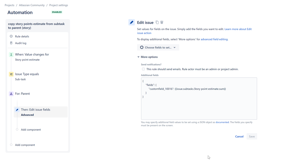

I could not reproduce this. If it still doesn´t work on your side could you also try to use the option via "customfield_id" instead of the fields name? On my side this looks like the following:
In case neither of these options works I would recommend to raise a support ticket with atlassian support.
October 18, 2023
Hi @Stefan Salzl
somehow I can't find the customfield_id because it seems like not a custom field.
Do I need to be an admin to raise a ticket?
