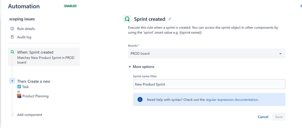

The automation created is per the attachment.  However, when i create a new sprint nothing get added to the new sprint; plain blank.
The rule is published and active.
The audit report: No Action performed

So that rule is only ever going to run once, when you create a sprint called exactly "New Product Sprint".
My guess is that is not what you are calling your next sprint.

Nic Brough -Adaptavist-
January 22, 2023
The simple answer is to just not try to use the "sprint name filter".  Left blank, your rule will execute for every sprint created from that board.
The field is there for the more complex cases - "Our board is running many sprints, but we only want this rule to run when the sprint name contains the word 'Aspidistra'"  I suspect you simply want to run it for all of your sprints, so just leave that field empty.

Thank you so much Nic.  The rule works Greatly appreciated and appreciate your resourcefulness.

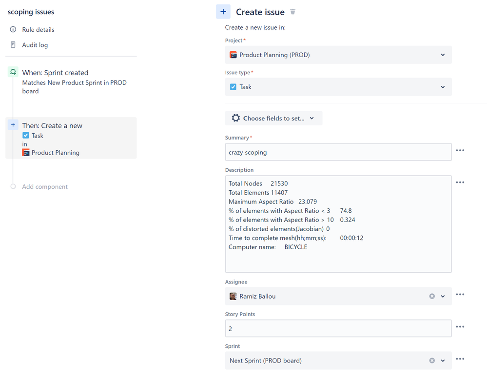

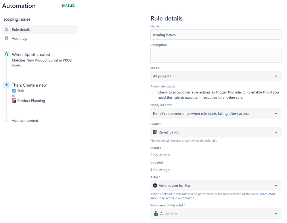

so sorry for not including cnfig info. the following provide details for rule details, trigger, and action
