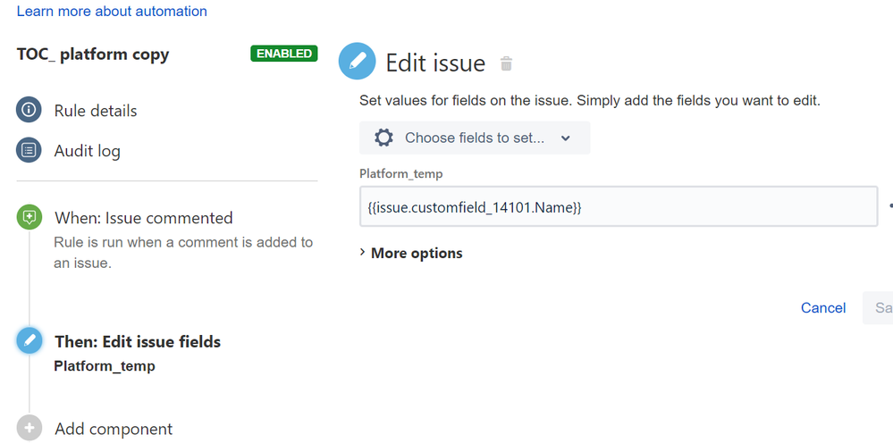

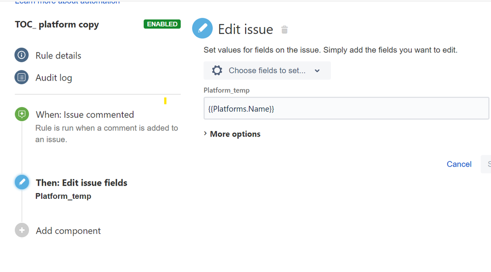

NEGAR JALALIAN
May 27, 2024
sure :
platforms.pngalso I tried this : platforms temp 2.png
but none of them worked

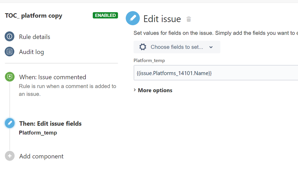

NEGAR JALALIAN
May 27, 2024
I also tried this but it didn't help :
Jack Brickey
May 28, 2024
Thank @NEGAR JALALIAN . Let's try
{{issue.customfield_14101}}
also can you add a log action to store the value of the above? Then by viewing the audit log, you will understand what the smartvalue is equating to which in turn help you zero in n the correct smartvalue syntax.
NEGAR JALALIAN
May 28, 2024
you saved so much of my time ! it workkkkkeddddddddddddddddddddd
thank you sooooo much !
