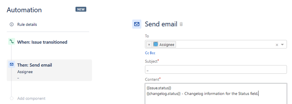

Alexander Pappert
March 13, 2021
Giorgi Tsitsvidze

Alexander Pappert
March 16, 2021
look in my screen from the fist post
Giorgi Tsitsvidze
March 16, 2021
alexander thank you for your answer  , but i think u dont understood what really i need to do ...
because this information is not interesting for me -
changelog - "when an issue is transitioned you can see what status the issue transitioned from."
let me explain again ...
i need to send email with transition link ,
when recipient click on this link , jira issue change status from 1 status to another (next status) ...
i need to send this email when issue create , and link will be - for change status from backlog to approved or rejected status...
i have question - is it executable or not , with jira automation or without this app ...
