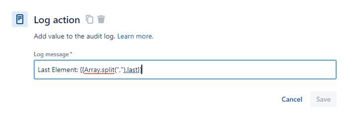

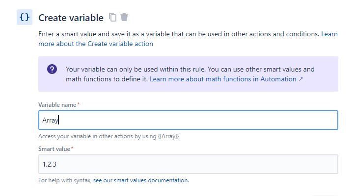

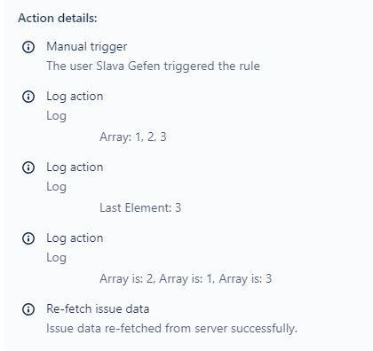

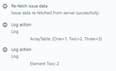

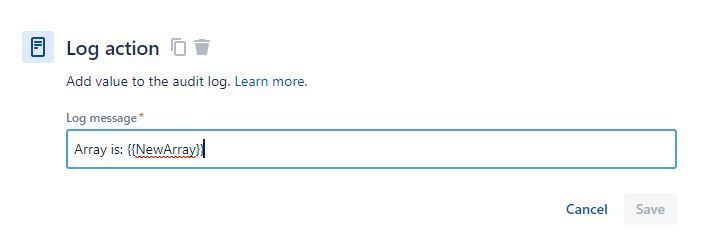

It seems after a while I was able to solve this issue. Bellow is the example of my Automation rule. This Automation is getting a list from 1,2,3, ... string variable.
1. Set a manual trigger
2. Then create a variable
3. Then add value to the log
4. Then make additional Log
5. Then create Advanced branching
6. And finally log action again
As a result, you'll get this:

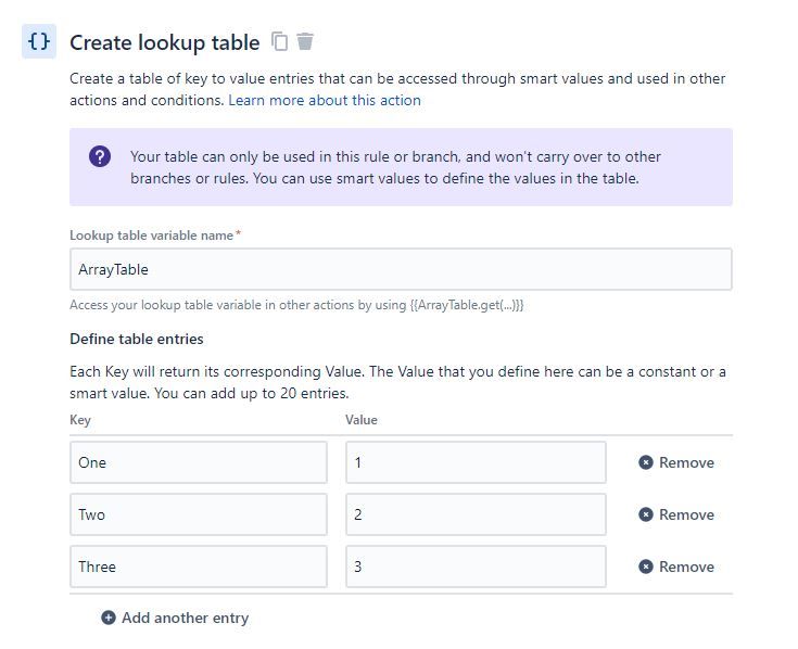

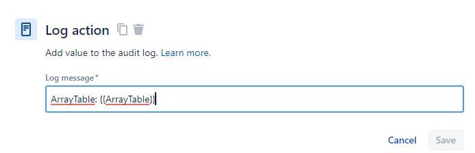

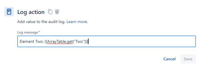

Even More you can continue with the new available smart-value called lookup table
1. At first this
2. Then Log action
3. And finally access your table
Hope it helps!
With kind regards
Slava

Slava Gefen
April 16, 2023
.that does not help in this scenario as the advanced branches are executed asynchronously and non-deterministically
@Bill Sheboy could you please describe the exact scenario you want to achieve?
