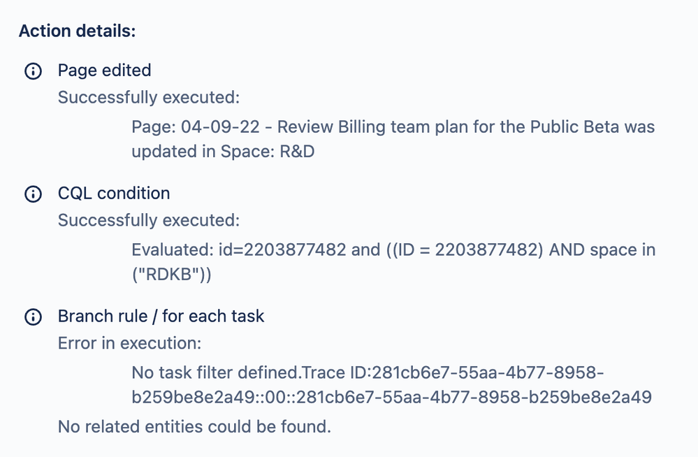

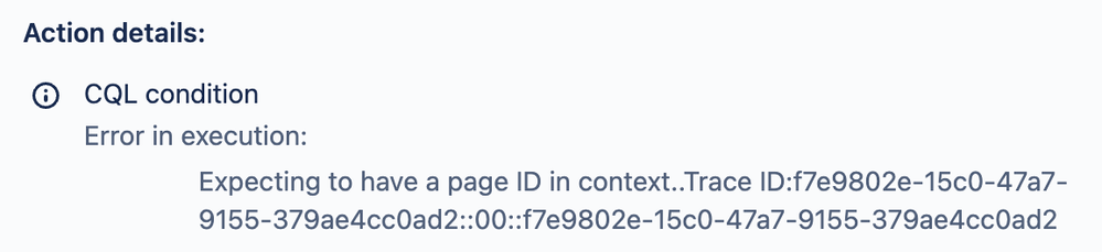

Im trying to build an automation that sends a list of open tasks from a page to Slack by schedule. Im getting the attached error, not sure how to proceed. Adding the automation itself as well. I tried to change the condition a few times to several options but no success.

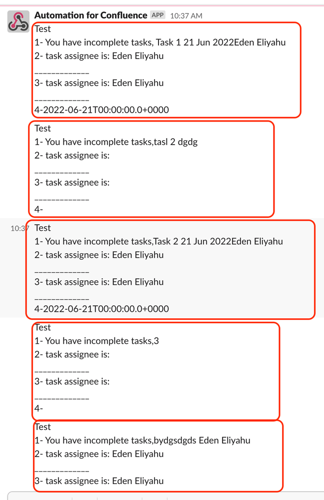

We were able to send slack messages regarding incomplete tasks, but there is one major problem: we couldn't send incomplete tasks for a specific page.
Message sent to Slack with all the incomplete tasks in all the space.

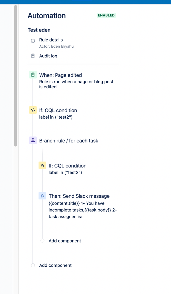

@Alex Koxaras -Relational- We tried. Unfortunately, no.

If you use the label on your CQL, of course it will check every page. If you want your tasks to be from a specific page, then add the ID = your_page_id

This is the only page with this label. :)

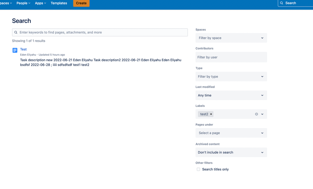

@Eden Eliyahu what about the archive content (I see a check box on the image above). do you have any other page with the label test2 which is archived?
And what about the results you are getting? They are from which page? WHat is the label on that page? Did you at any point place the "test2" label on that page? You have to provide me with all the necessary details/screenshots.

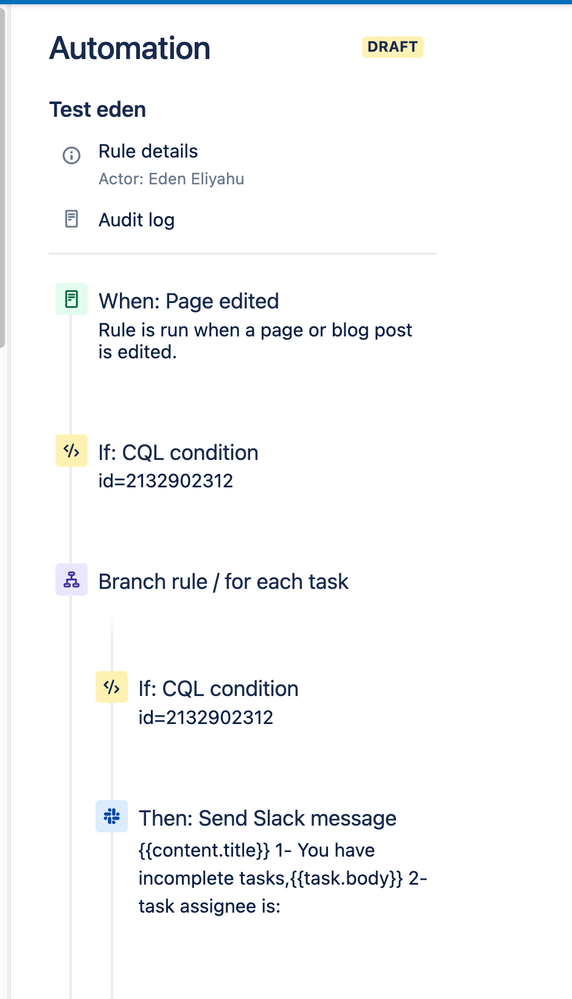

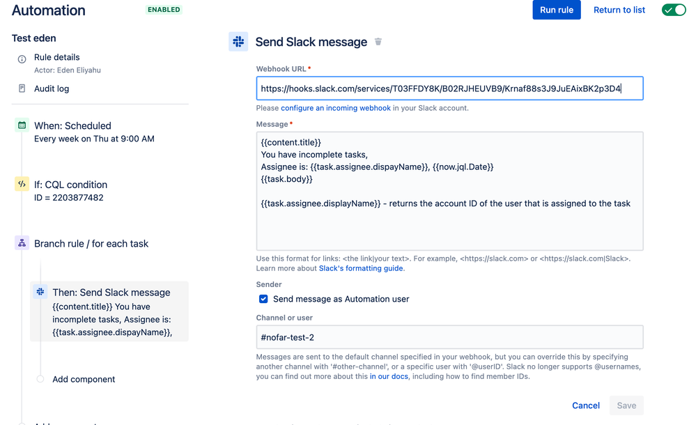

@Alex Koxaras -Relational- We also tried to do "if" with page ID and not labels, and the results are the same.

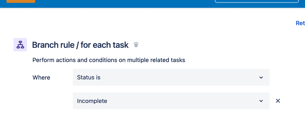

(The rule includes the incomplete tasks only)
attached:
1- The rule with the page id condition.
2- The slack message (5 tasks)

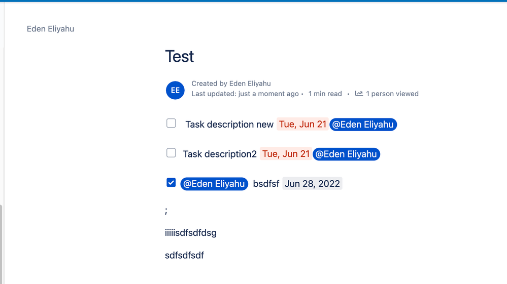

3- The confluence page (2 tasks)

I changed the trigger as well and got a different error, can you take a look? image.png
September 11, 2022
Do you have on this specific page (CQL) any task? If yes, in what form?

Yes I have.

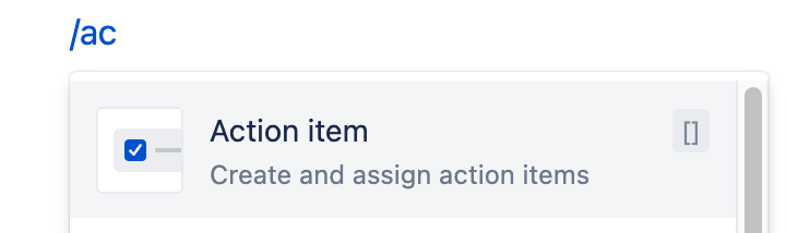

September 11, 2022
Can you please share a screenshot of your tasks?

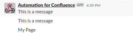

I have two tasks and sending messages to slack is just fine.
