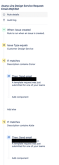

Hi @John Funk - thanks for your response. If you say my response below, you'll see the way the rule is set up in Asana. What I was referring to in my post was mostly about Jira.
So I have a few rules set up related to this.
1. If the form is filled out for a design service, then it triggers the following:
Screen Shot 2022-10-04 at 3.36.17 PM.pngScreen Shot 2022-10-04 at 3.38.59 PM.pngthis email one is actually longer, but it's the same setup for a bunch of different colleagues with this if/then.

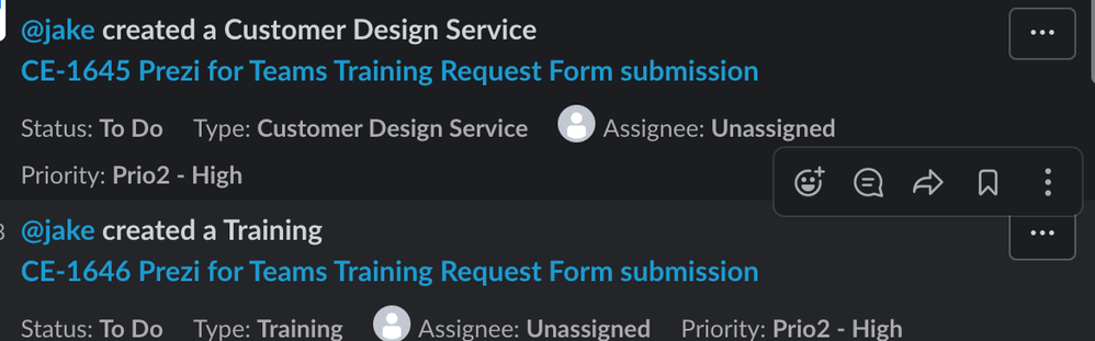

When I created the same rule in Asana for training requests, with a similar rule for sending an email out to the appropriate colleague, two jira cards were created - it triggered a design card and a training card at the same time, as you can see here:

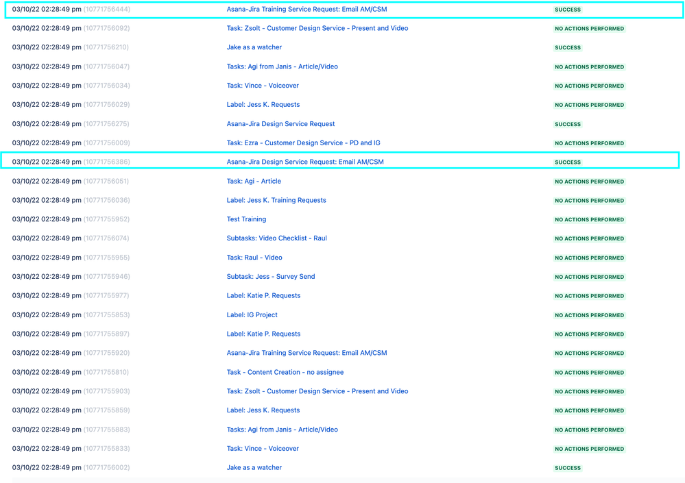

When I look at the audit log for when this happened, you can see that it went through all the rules and both were triggered, even though the form that was filled out in Asana was set to create a Training issue, not a Design issue (see blue highlights)
Let me know if that helps clarify what I'm trying to figure out here! My best (and only) guess is that when Asana sends the request to Jira, Jira sees the request before the issue type, and is therefore going through the rules until it realizes it's a specific issue type that it should follow the rules of, not both.

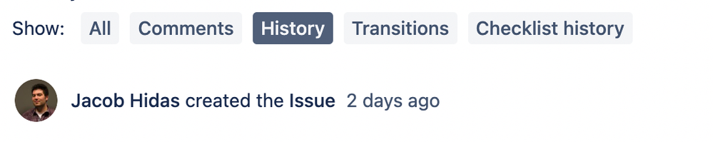

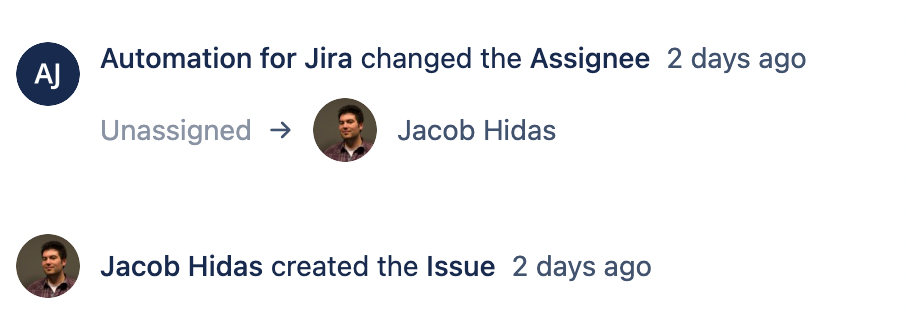

Did you check the issue type of the Training Service issue to see what value it actually got created with? You can look in the History of the issue.
Jacob Hidas
October 5, 2022
Hi @John Funk - checked and nope, each issue was created separately, no changes in issue type. The only change is the automation on one of them making me the assignee.
Screen Shot 2022-10-05 at 10.42.31 AM.pngScreen Shot 2022-10-05 at 10.42.24 AM.png
