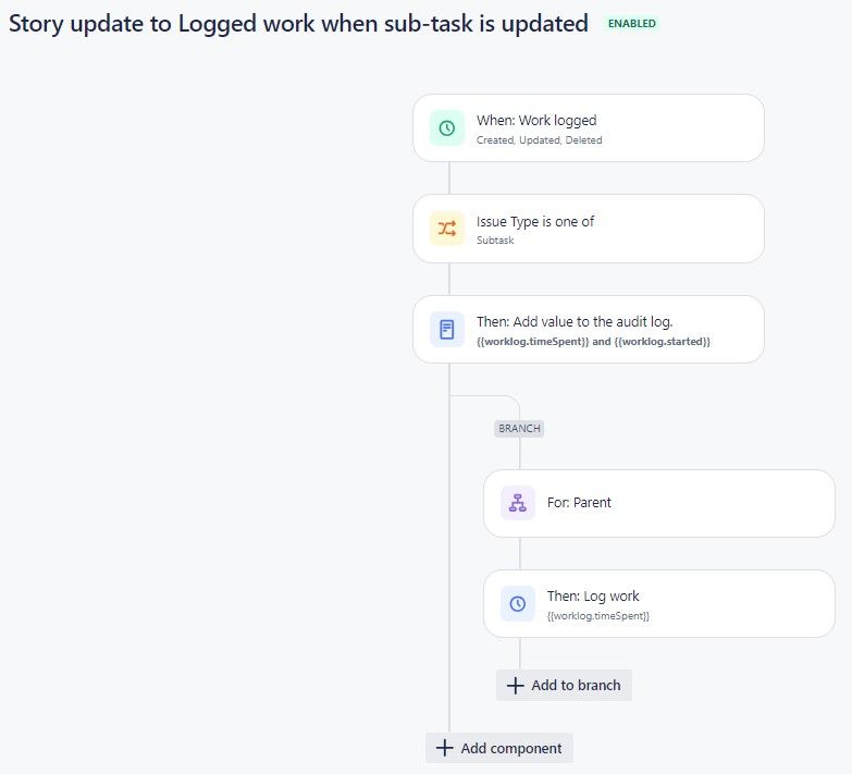

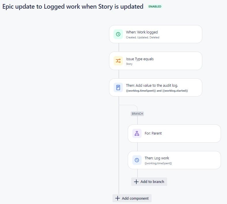

I got the Epic work log script to work by using 2 scripts.
They are pretty much identical, with one being initiated by a sub-task to update the work log on the parent story.
The other being initiated by the story to update the work log on the parent Epic.
The story initiated rule has "Check to allow other rule actions to trigger this rule. Only enable this if you need this rule to execute in response to another rule." box checked.
Rule to update the Epic work log from a Story update.jpgRule to update the Story work log from a sub-task update.jpg

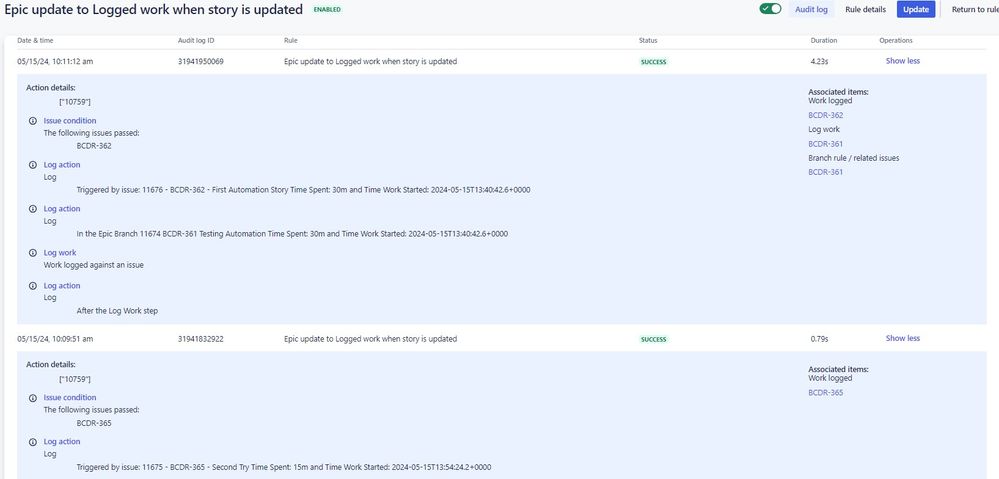

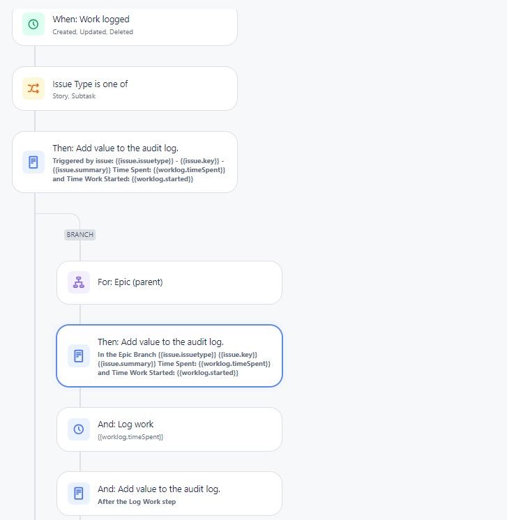

Bobby Williams
May 15, 2024
@Kalyan Sattaluri @Bill Sheboy
Sorry for the delay, but I found out that my automation wasn't working for summing up the total logged work into the Epic. I am using the flows from several articles in the community, but it doesn't work when work is added to a sub-task which adds to the story, but not the Epic.
If I manually add time to the Story, the epic is updated. My calculations above are not even being considered by automation.
I am now back to troubleshooting the automation to update the Epic with time logged on a sub-task of a story.
Audit log showing that a story triggers the rule, but not a sub-task of the story.jpgAutomation flow diagram.jpg

Bill Sheboy
May 15, 2024
As written, I would not expect that rule to update a Story when work is logged for a Subtask.  The reason is the branch is to Epic (parent), and Subtasks do not have an Epic for a parent.

Bobby Williams
May 15, 2024
As shown in the rule diagram above, if I manually add work log time to a story, the Epic work log gets updated.
However, if I add time to a sub-task, the story gets updated (include child issues is checked), but the Epic doesn't get updated.
It would seem that if the Story worklog get updated, either manually or cumulatively, then the Epic would update its worklog.
Manually adding time to the Story will update the Epic worklog.
