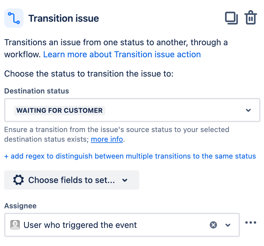

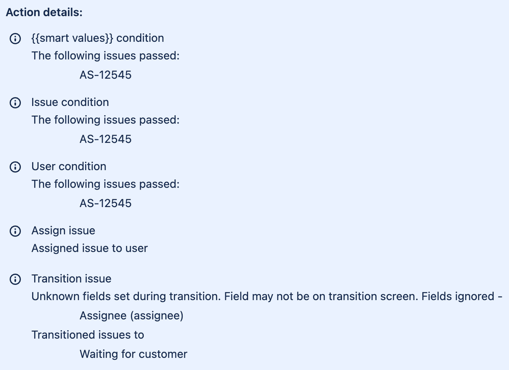

Hi all,
A tat late but I think I found the cause.
The assignee was set twice. Once during the transition step and once after.
Setting a field during transition is only possible if it's on the screen I guess.
See the audit log.
Will let it run for some days. If you have another remark on this setup, please let me know, thanks!
