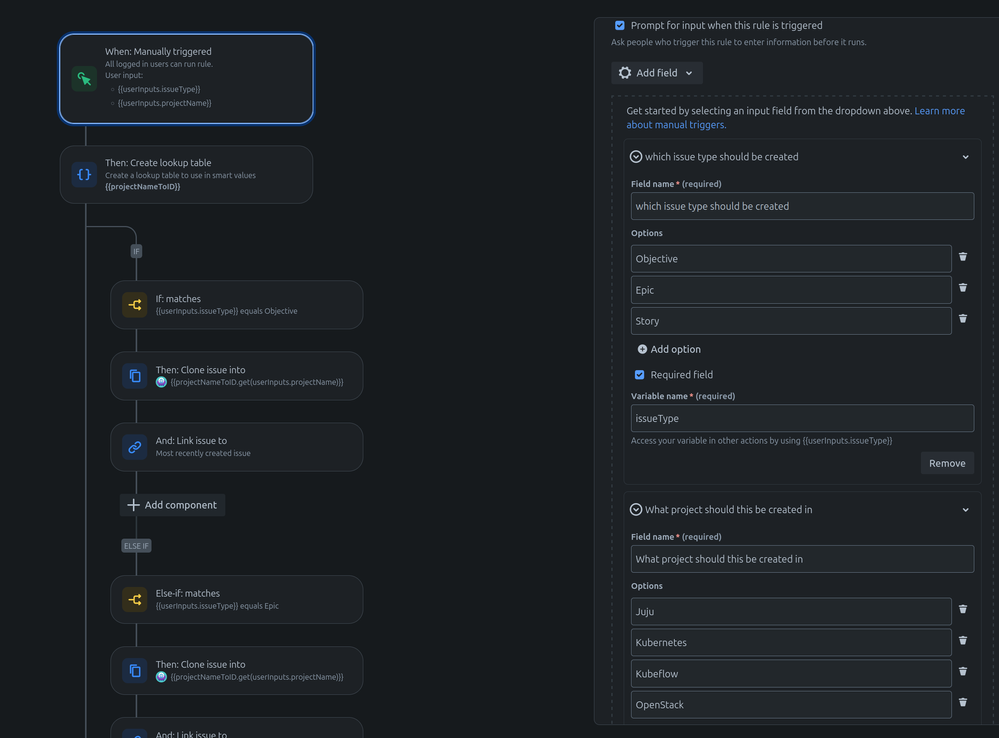

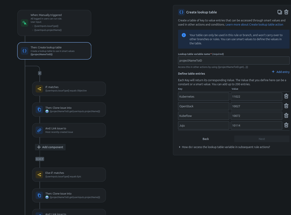

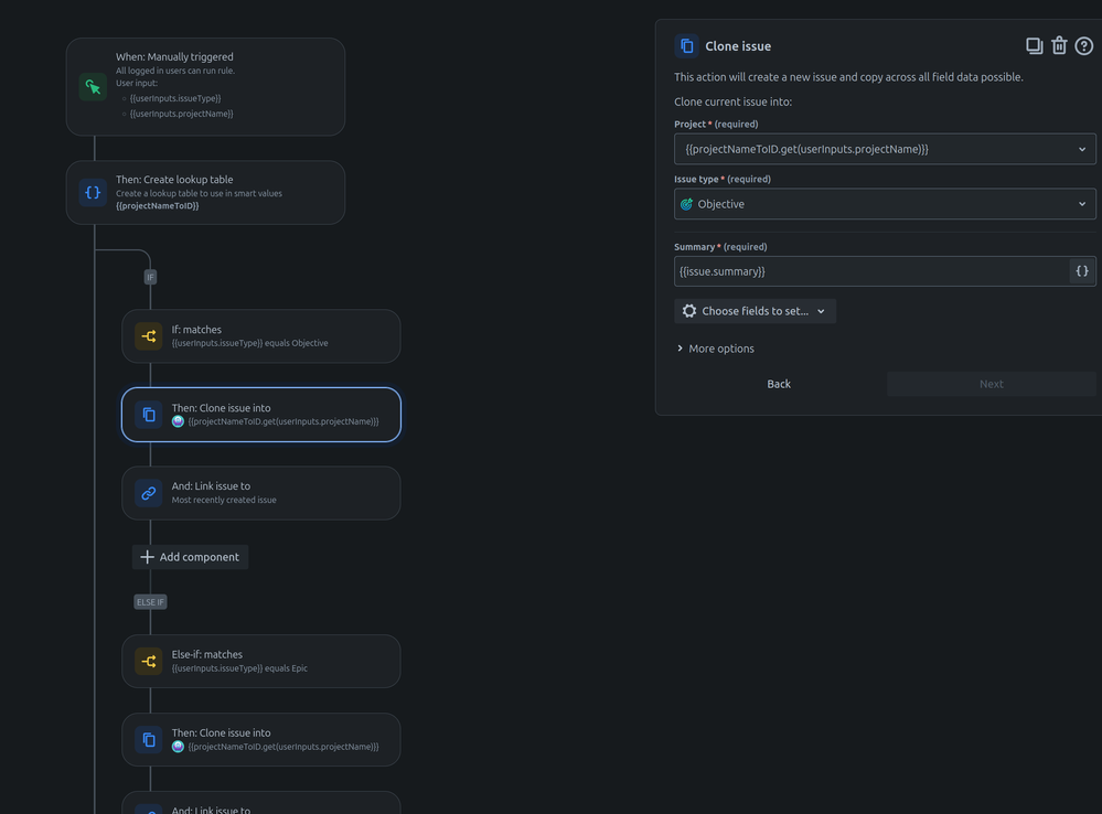

I ended up with an entirely different solution. Thanks to the newly added lookup functionality it is made possible
1. Ask use for the input where they would like issue to be created and the issue type
2. Create lookup table with Project Names (or whatever names you have in the user input) and the corresponding Jira project keys
3. Clone issue based on the IF condition

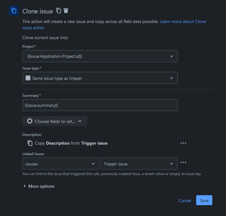

I have just tested that with "Clone issue" functionality and it does accept smart value. It needs to be a project ID but it does work eventually.
My case is that we have Application catalogue in Assets and each application there has attribute called "Jira Project" (field type Project). User on the portal has to pick Application that his change/incident/request is connected to and if the L1/L2 is uncappable of solving that request a simple workflow status "Escalated to L3" will result in automation being run. This automation checks application selected in assets database and use "Clone issue" with this smart value: "{{issue.Application.Jira Project.id}}" used in Project field. You can use the same way for issue type or select directly whichever you want to have.
It does not utilize user input as you mentioned but the basics are the same (and I hope it works for Create issue too).
