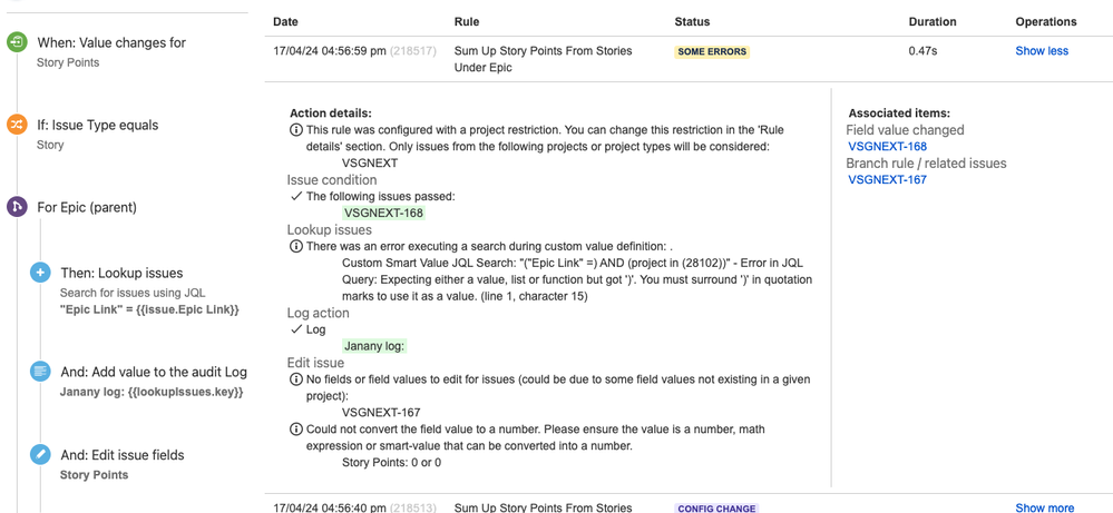

I have looked at all the threads related to this issue but so far no workaround for the problem I am seeing.  I have the automation set up as in the attached screen shot.
https://www.youtube.com/watch?v=PROcxEOMyGM is the video I was following.  In the video it uses action issuetype in (story) and "Epic Link" = "{{issue.Epic Name}}" that didn't work so I changed it to "parent" = {{issue.key}}. However I still see the epic's Story Points field keep getting reset to zero.
Not sure why this is happening.  Please help.

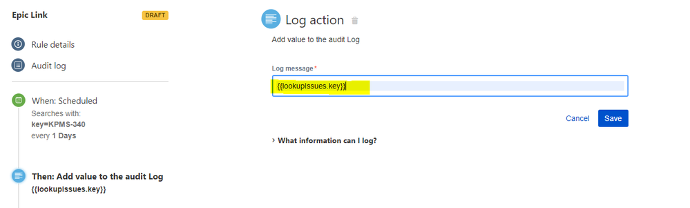

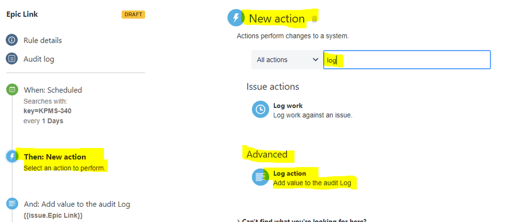

To do this, add component above "Edit Issue" -> New Action - Type Log in search box, under Advanced, there will be "Log Action". (see screenshot 1).
Then when you have selected that option, put in {{lookupIssues.key}} and hit save. (see screenshot 2)

I did the log statement as. you suggested.  However I don't see any log entry in the ticket.   Where should I see this logged?
As for doing the JSON, when I opened the URL with ?expand=names I am still getting the same normal view (not a JSON response).

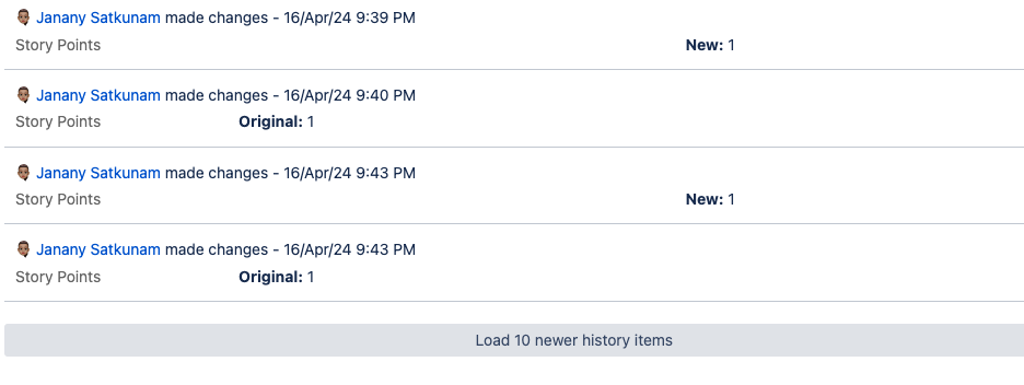

Also I can confirm we do use Epic Link which is cf[10008].   But one thing I don't understand is why the Epic's Story Points value get set to zero.  For example, I just updated to a random number and then I went and updated the child story's 'Story Points' field.  As soon as I did that, the parent's story points field got set to nothing.
See attached screenshot from the history tab of the epic.Screenshot 2024-04-17 at 12.26.45 PM.png

Janany Satkunam
April 17, 2024
HI Kalyan,

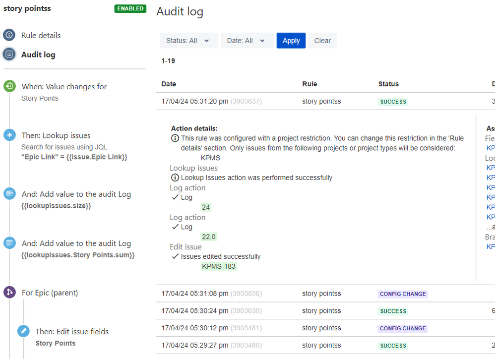

I see the below in audit log.  Is this because of the reason you are explaining above?
I do want a solution to achieve my desired output.  Please advise on next steps.

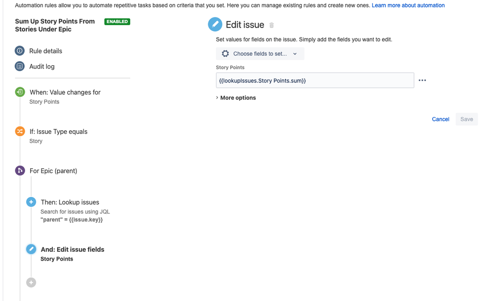

Kalyan Sattaluri
April 17, 2024
@Janany Satkunam
Never mind, I had a typo earlier when I was testing. We can do this simply.
Please make your rule just like I have below and share audit log screenshot if issues.
Thanks!

Kalyan Sattaluri
April 17, 2024
@Janany Satkunam
What you have for the edit issue should work. that is assign it the {{lookupIssues.Story Points.sum}}
Also, ignore what I said earlier. I had a typo and was mistaken.
Please implement like I have in my screenshot, trigger the rule by changing a story's points and check epic field and share audit log if it does not work.

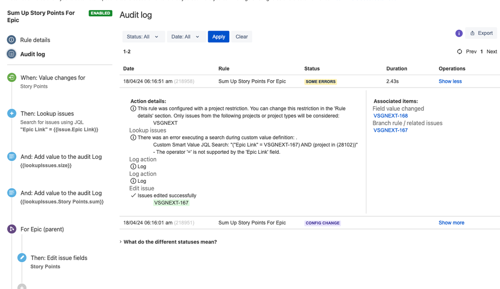

Still getting set to zero.  See the audit log below:

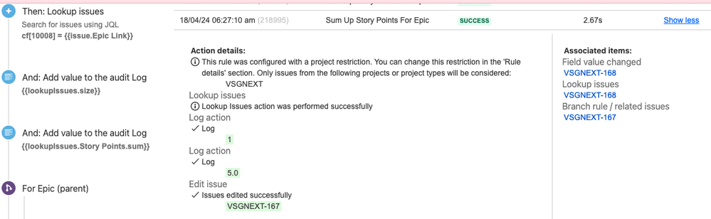

Hi Kalyan,  I got it to work!
There are two fields called "Epic Link" and it was using the wrong one.  So I changed the LookUp JQL to cf[10008] = {{issue.Epic Link}}. and it started working.

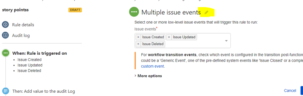

Right now the rule is only triggering on create or edit actions.  I want the story points field of the epic updated anytime epic link is updated to this epic or if a child is deleted or moved.  Can I accomplish all of this in one action?
Kalyan Sattaluri
April 18, 2024

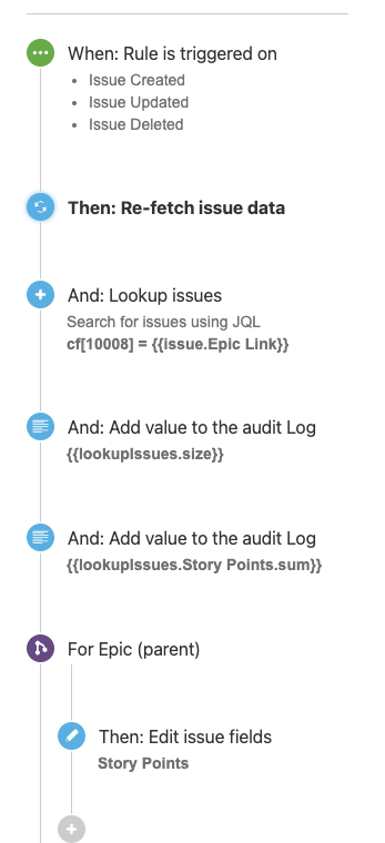

You can just use "Multiple Issue Events" trigger and choose Issue created, Issue Deleted, Issue updated triggers together and update epic. It should cover all your scenarios. Do note that for for issue created scenario, you need to include an additional Re fetch action because usually the rule does not have all the fields at hand when issue created is the trigger. You could separate that out as a rule by itself and rest, combine them in 1 rule. Hope it helps and as mentioned in below, please accept that answer for future reference. Thanks!

Can you let me know how use "Multiple Issue Events" for the rule I have?  Also how do I delete a component on the automation rule as currently I don't see an option to do this.
Kalyan Sattaluri
April 18, 2024
Right now you have field value changed, instead you will choose "multiple issue events" trigger as below.. My suggestion is, keep "Issue created, Issue updated" together and Issue deleted a separate rule.. And add a refetch action step after trigger..

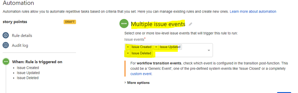

Janany Satkunam
April 18, 2024
That is super helpful.  Thank you!  Does the below look right?
Kalyan Sattaluri
April 18, 2024
I dont have access to delete issues in my instance so I dont know if re fetch will work for that scenario.. but even if that step errors out, epic will still be updated. Thats why I said to separate Issue deleted as its own rule. You can simply go back to your rule list and copy current one and modify the trigger so it should not be a lot of work,
Finally, one last addition, before refetch,  include an if condition, issue type check and check if issue is a story/task, only then continue with refetch and other steps, cause this rule as it is now will run for changes made to sub-task/epic etc which you dont want...
If you make that change, everything looks good. Try it and share if issues.
