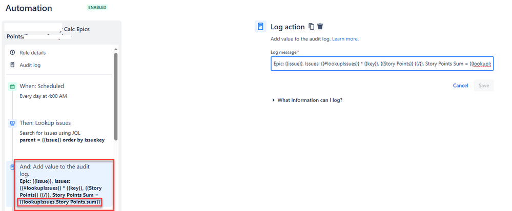

I have an Automation Rule that runs on just Epics and does this lookup:
parent = {{issue}} order by issuekey

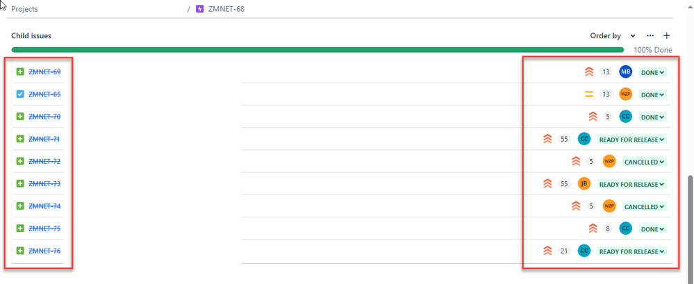

I want to get a sum of the story points of the children of that epic (I've attached a screenshot of the children with their story points)
I've put in a log entry to show the children and their story points, then using this to show the sum of those story points:
{{lookupIssues.Story Points.sum}}

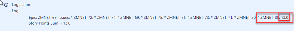

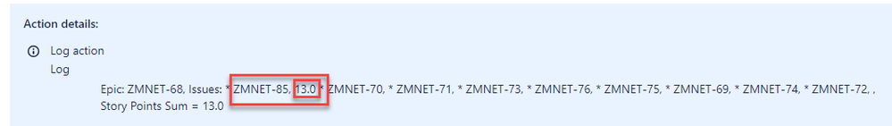

I've attached a result of 2 different log runs with the only difference being the order by order for the lookup JQL
But looking at the log, it shows story points only for the first child that is shown on the screenshot showing the epics story points, (this is the case even if I change the order by field) and the sum of the story points is only the story points for the first child.

I figured it out.
There was an issue type that was not in the Default Configuration Scheme for Story Points.  So, while the issues for that issue type had story points, automation did not get them as they were not part of the scheme.  I added them to the scheme and it seems to be working.
