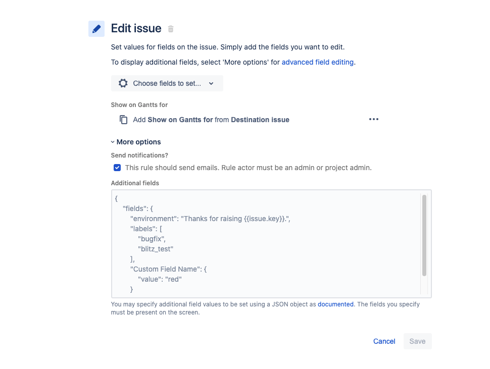

1. How can we read which project the ticket is part of so that we can define this to be the value that's copied down (it doesn't appear to be a default field we can copy a value from)
2. How can I populate the target multi-select field - it doesn't appear to be available. I've found some community posts that indicate the fix is to use the More Options JSON but I can't find any training for coding novices on what to actually put in it.

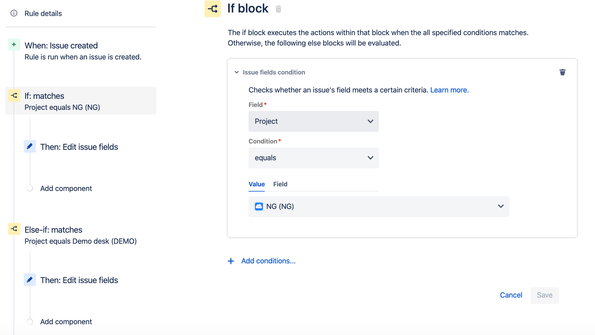

I would suggest you to use if/else condition block along with "Issue fields condition".
Trigger: Issue Created
Condition/Action: if -> project equals NET then -> edit issue(choose custom field from drop down  Screen Shot 2020-09-23 at 10.45.52 am.png) and for value, select appropriate value from dropdown out of all the multi-select options you have.
else if -> project equals DIGI then -> edit issue(choose custom field from drop down) and select value from dropdown out of all the multi-select options you have.
No need to use advanced json part.
Something like this:

Yes you can achieve this using JSON, something like this:
"update": {
"your_custom_multiselect_field_name": [
"set": [{"value": "{{issue.project.key}}"}]
For more details and usage with examples, you can refer here.

Almost there I think. I thought this would work:
"update": {
"customfield_10054": [{
"set": [{
"{{project.key}}": "{{issue.project.key}}"
 and I can successfully write in the Project Key as a label using a similar technique. But when trying to use it to set the content of customfield_10054 I get:
Error editing issues DEMO-42 (Field 'customfield_10054' cannot appear in both 'fields' and 'update')
Thoughts?
Sherry Goyal
September 23, 2020
You can set value like:
"customfield_11448" : [ { "value": "option1" }, { "value": "option2" } ]
or
"customfield_11448" : [ { "id": 10112 }, { "id": 10115 } ]
So either use value or id not "{{project.key}}" inside set .
