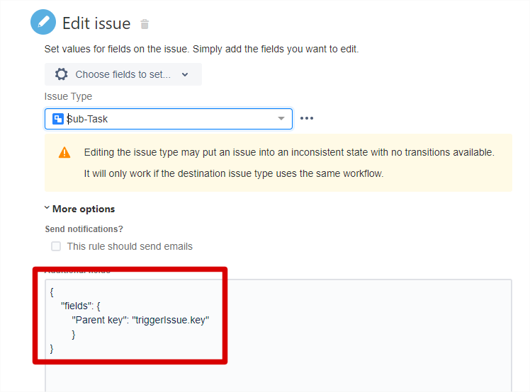

I am trying to create  an automation rule to transform a "Task" issue type in a "subtask" one when this Task is linked to another parent issue.

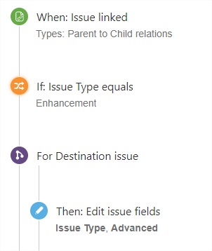

Trigger : when a link is created between 2 parent issue - 1 of type Enhancement and 1 of type Task
Then I would like to transform the Task into subtask of the Enhancement.
I'm using the "Edit fields" action to change the issue type. "Parent key" is not available as a field to be set. So I try it in the advanced mode.
This Automation is not successful, I should have something wrong in my JSON in Advanced mode.
Error I get is "Issue type is a sub-task but parent issue key or id not specified. (issuetype)"
Thank you for your help.
Romain

Hi @Romain VELON ,
We currently don't support converting "tasks" to "subtasks". This operation can often require an "issue move" operation which involves field/workflow mapping depending on your setup (if you go to your task click the "..." and hit convert to subtask you'll be taken through the remapping).
As mentioned above the alternative is to use the "Clone issue" action, set the issue type to subtask and the parent issue to trigger issue (and then clean up the old task).
Hope that helps,
John

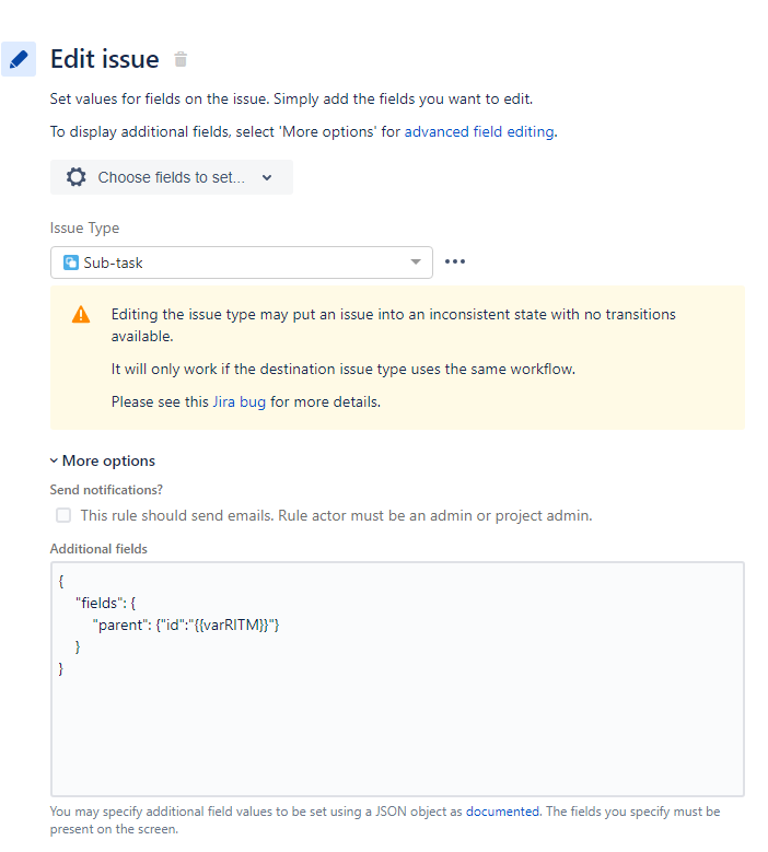

I was able to convert an issue to a subtask, just not sure what field to update to specify the parent. If subtask and issues are both using the same workflow it seems feasible.
Richard Vencu
October 17, 2020
OK, got the same error as mentioned here.
If there is no attempt to set up the parent key then the issue can be converted to subtask but it is not linked to any parent so probably not very useful. Going to explore the clone issue route as well.

Question @Romain VELON the "Parent to child relations" in your trigger....is that a link type description you have in Jira? As i don't see that option, only link types that we have set up in our instance.
I only ask as I was looking the other day for a way to trigger from changes to the Advanced Roadmaps "Parent link" filed.
Romain VELON
September 9, 2020
Hi @Curt Holley ,
Yes this is a link I created on the instance.
