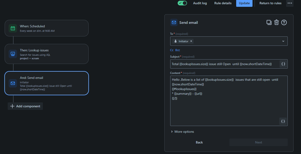

Duc Thang TRAN
July 3, 2024
Hello @John Cross
Here is my suggest :
Hope this can help you
