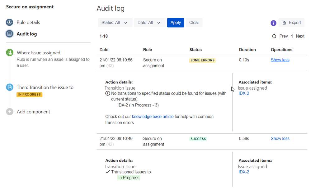

At first, the rule was just two components, the trigger and the action. It would return two status entries. First:
Success. Transitioned issues to In Progress
Then the second status:
No matching transitions could be found for issues (with current status):
IDX-2 (In Progress - 3)
Apparently, it's reporting an error because it can't find a transition from "In Progress" to "In Progress" when it attempts to run the transition a second time.
Screen shot with example of these back-to-back log entries.

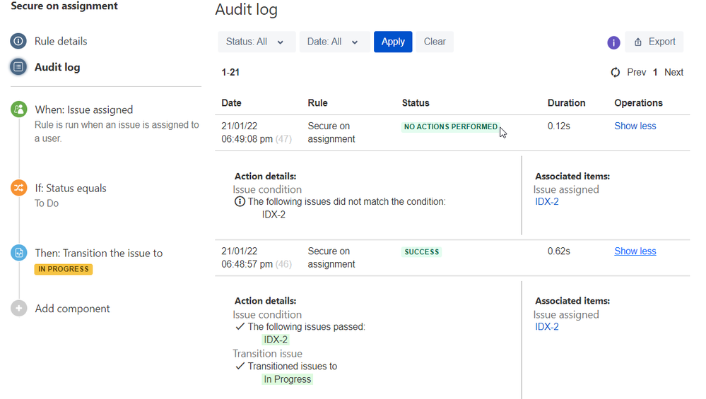

To verify it really is trying to run the action twice, I added a condition: only run the transition if the starting status is "To Do."
Now it returns two statuses again. First it transitions the status successfully, like before. The second status is no longer an error--it just reports doing nothing, since the criteria to run the action wasn't met when it tries to run a second time.
