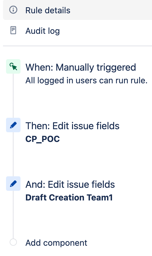

Shilpa G
August 10, 2021
The above can easily be called and fields get updated, but the same does not work on issues created, issue transitioned, etc.

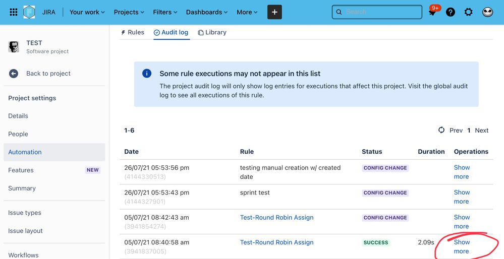

@Jack Brickey Please can you share steps on how I can get the audit logs?
Jack Brickey
August 11, 2021
On Aug 10 you replied to Melo with an image of the audit log but it was only for the config change. The point is that The audit log is in that very place where you took that image.
project settings > automation > audit log
find the entry that is associated with the create issue event. It may show success or failure. Click on show more and share the results.
Shilpa G
August 11, 2021
It doesn't show anything only says Config Changes every time I edit it.
CP_POC is a multiple group picker field that I am trying to update.

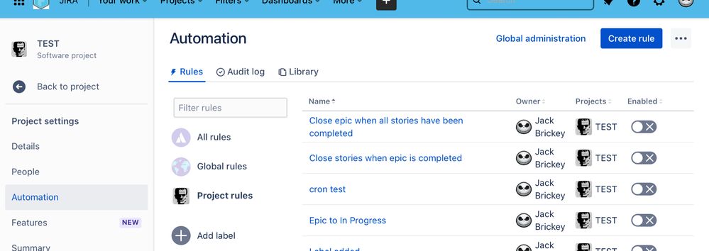

Jack Brickey
August 11, 2021
Ok. For the project associated with these issues please go to the following location and give me the screenshot. Project settings > Automation
I want to see the list of rules for that project and please indicate which rule is in question here. Similar to below.

Shilpa G
August 10, 2021

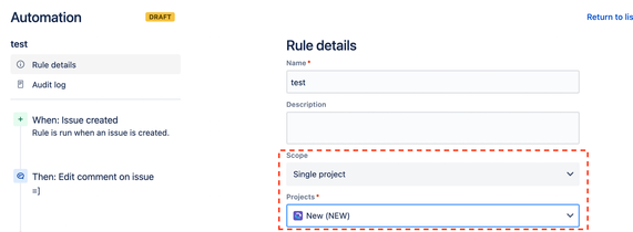

Hi @Shilpa G,
As mentioned, you should check the scope of your rule.
You can do that by going to "Rule details", then select the "Scope".
I would suggest using a single project, like the example below.

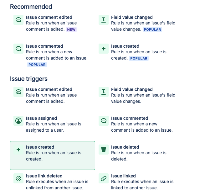

Melo
August 10, 2021
Also, if you're not planning to trigger this rule in multiple events, you can choose the trigger "Issue Created" instead of "Multiple events">"Issue Created"
