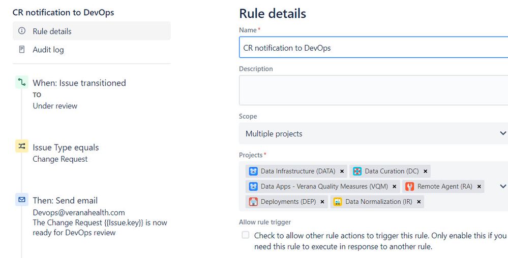

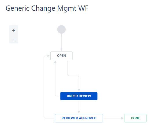

Rule was created so when an issue is moved to Under Review, and is a Change Request, an email is to be sent to Devops. It was working. Then turned off. When turned back on, it has not started working. I even recreated and that rule is not working. What am I missing?

Hi @Paula Manildi ,
Is your workflow transition configured with a custom event by any chance? You can see this in the workflow's post-functions.  It should be firing a 'Generic event'.  If it's any other type of event then this wont work currently due to a limitation in Jira Cloud, where Jira wont trigger a workflow transition event if a custom event type is used!

That was it! it was a custom event, I changed it to a generic one and it works now
