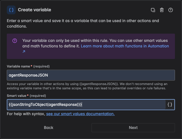

I am trying to treat the response from a Rovo agent as a JSON object and reference it using dot notation.  I have the agent response formatted correctly. Excerpt here:
{ "documentStatus": "PRD In Process", "documentOwners": [], "projectStatus": "", "prfaq": "", "epicTicket": "", "targetRelease": "", "designer": "", "techLead": "", "relatedDocumentation": [], "termsAndDefinitions": ""}
but I am unable to access any of the information outside the entire response.
I have tried using the 'jsonStingToObject()' method both as an entire variable creation and individually in line during the automation.  I can not get any results with the jsonStringToObject call either in dot notation, or for the entire string.
Anyone here had success with either of these methods? Or know of a better one?

I came across this while trying to solve the same problem. The workaround that seems to have worked for me is saving {{agentResponse}} as a variable then passing that variable to the jsonStringToObject() function. From there I was able to use dot notation to call other values in the JSON that Rovo returned to me. Hope that helps you too!

It is the second one you show, {{jsonStringToObject(agentJSON)}} and then reference the attributes needed.  I recommend writing the entire thing to the audit log to confirm it contains what you expected.

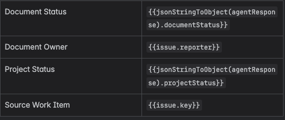

nvm, I found my solution:
First, I passed my agentResponse into a variable as instructed, but then because I have a lot of keys, I passed those all into a lookup table using:  {{jsonStringToObject(<variablename>).<key name>}}
Then I was able to access the lookup table for my needed values.

{{jsonStringToObject(<variablename>).<key name>}} works for me when getting a json array in the automation brach. But asObject and asList do not work in my case. Two steps: 1, creates a variable and assigns agentResponse to it (e.g workItemResponse = agentResponse); 2, retrieves the element (e.g {{jsonStringToObject(workItemResponse).work_items}})
