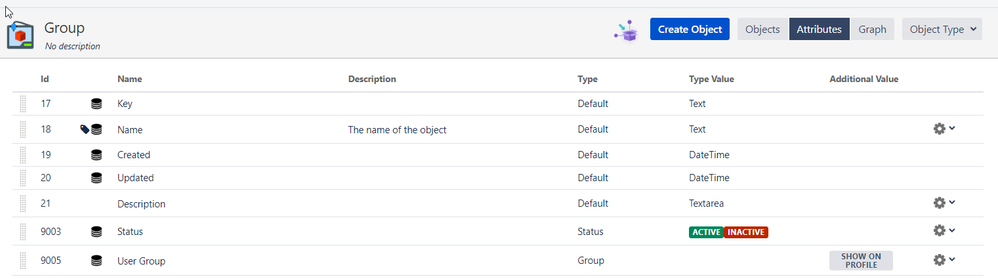

This is my current object definition.

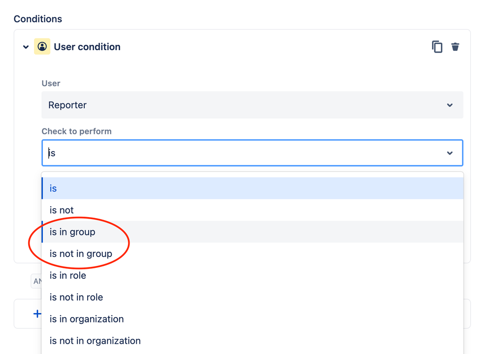

Within DC it looks like the User Group is actually a reference to the actual groups a user is a member of. In Cloud you can use the Group information but it's not Automatically added.
However, in this case you can use the IF/ELSE statement in Automation with a check if a user is part of a group. Unless somebody knows how the Group information can be retrieved within a custom field that is referencing object information that is referencing the groups in Jira.
In my case (in Coud) I can reference that customfield by the previous example I gave.

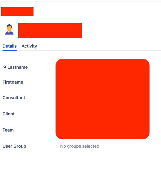

So you are saying that the Group is not pre-filed in the Object itself and therefore the same as with Cloud (not linked to the actual groups)?
If that's the same as with Cloud (a multigroup picker) than my reference should work but just needs the correct naming. Your object should then look like this (with no pre-filled group).
If so. If I want to see the Groups within a customfield value I use {{customfield_xxxx"User Group"}}. Let me know if you see a value pre-populated or not. If you do than you will need a different approach (with or without SR).
