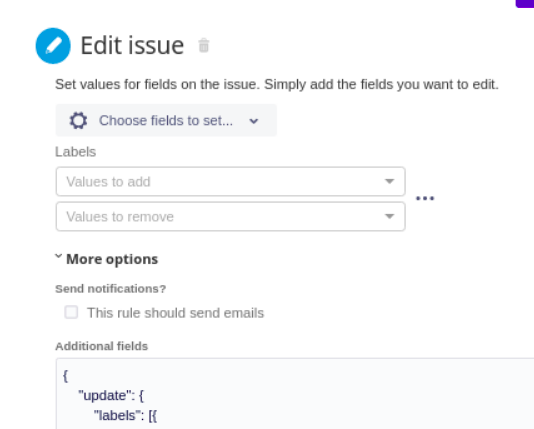

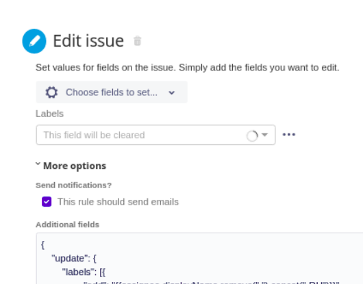

I just figured it out!
The syntax of the first example was correct. The issue was that I had the labels set to be cleared (look under the cog icon)
Once I removed the "this field will be cleared action" everything worked. I think the two settings were conflicting each other throwing it into a loop.
