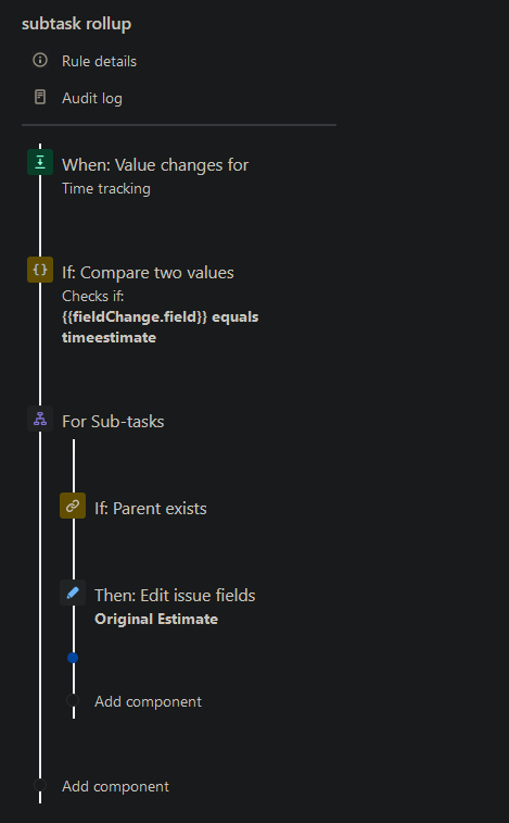

Baylor Peak
November 4, 2021 edited
Does this look right?:)
So what is happening when this rule is triggered, it is summing all subtasks in my project....
My test Parent is set to 0m for Original Estimate
Then I have 3 sub tasks each
Now, my Parent task is displaying 13w 2d 4h
Mykenna Cepek
November 4, 2021
Not quite. For this bullet:
  • Branch to the "Parent" (Story)
you'd want to use the following (instead of your "For Sub-tasks" branch):
Also, don't forget about this bullet point:
  • Use a conditional to only proceed if the triggered issue is a Subtask
That should be before the branch. This is because you only want to fall into this branch when the triggered issue is a Subtask.
Like Baylor Peak likes this
