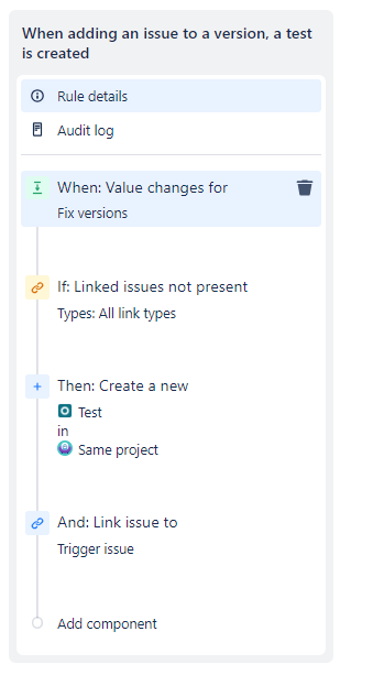

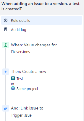

Hi there, I have an automation in place as screenshot below.
When an Issue has its Fix Versions field changed it should create a Test in the same project and link it to the Issue that triggered the rule.
But  - How would I make sure the automation didn't run again if I made the Fix Versions field empty, but then repopulated it again?
So, not creating and linking a new test if the issue got moved to a different Fix Version.

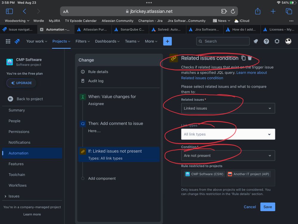

I think you can check for the existence of a linked issue. I recall doing that.
Jack Brickey
August 23, 2023
Try using Related issues condition

Amazing! I initially added that instruction at the end of the rule and wondered why it didn't work.
Instead I shuffled it around so that it logically made sense as below.
Thanks so much for your help.
