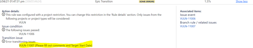

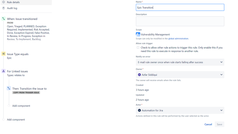

Attaching the screenshots of automation rule, and audit log.
Audit log

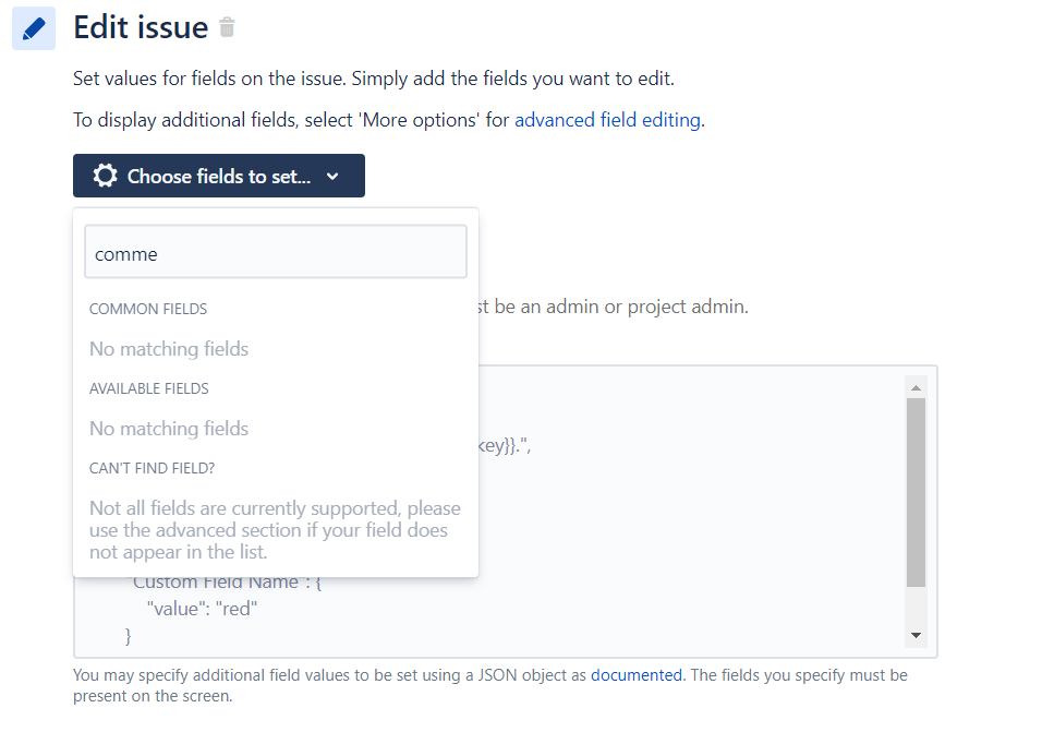

Thanks for the reply,  i cannot find "comment field" that i can use to copy from. That is one of the fields required to transition to next step. any way around this?

Commenting on an issue is a separate action from edit.  Perhaps try to add that Comment action inside of the branch, and you may add the value from the trigger issue's comment.  Unfortunately this method will not preserve the original author, but you could add that to the comment.
Comment from {{triggerIssue.comment.last.author.displayName}}
Created: {{triggerIssue.comment.last.created.jiraDate}}
{{triggerIssue.comment.last.body}}
