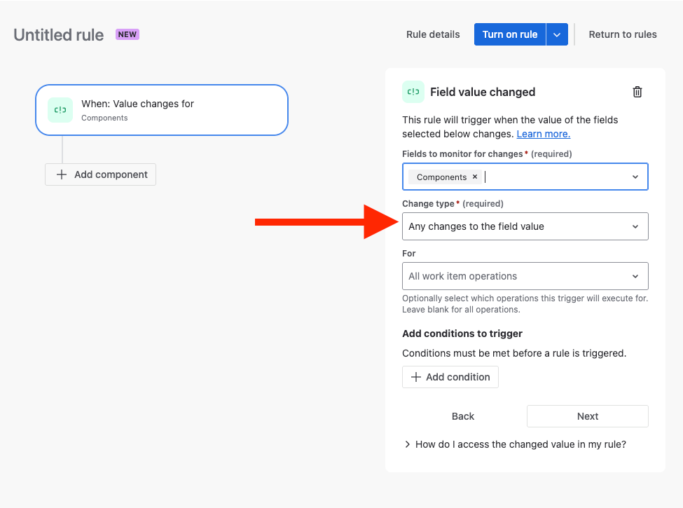

Hello @rachel rutti
You should see that as part of the Trigger:
If you are not seeing that, please provide a screen image of what you are seeing.

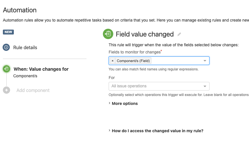

Looking at one of your previous questions:
...we concluded that you were using Jira Data Center. So you are likely seeing something like the second image I provided, and you won't have the option to specify "value added" as part of the trigger.
It will be very useful if you include that information in any future questions you post.

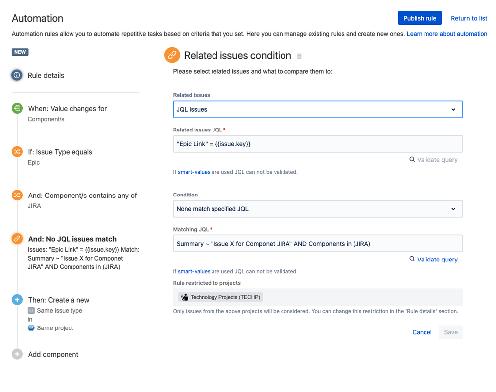

This is the rule I recommend you try. In my example the Component of interest is "JIRA".
After the trigger add a condition to make sure that the trigger issue is an Epic. Otherwise it will be run when Components are changed for other types of issues.
Then there is the condition to check that that the Component value of interest is in the Epic.
Then use a Condition: Related Issues: JQL. For the Related Issues field select JQL. For the Related Issues JQL use what I have shown. That tells Jira that you want to look at all the child issues of the Epic that triggered the rule.
For Condition choose None match specified JQL.
For Matching JQL use a JQL statement that would match the issue you want to create. Since the Condition is "None match" this condition will Pass only when the Epic doesn't have an issue that matches the one you want to create.
Following that is the last step to Create the new issue.

Hello good day it is! Your suggestion worked! Thank you!! Will be adding more rules for more components and testing adding multiple components and removing them, but I think you have provided a solid solution and it was very timely so we are very grateful.
