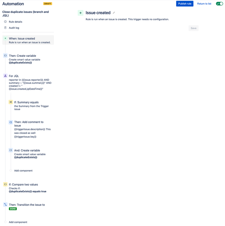

Ok so this is a bit hacky and I have not tested all cases (but I think it works). I'll explain each component and configurations below the image.
The automation is run whenever a new issue is created. It checks to see if any existing issues have the same issue summary and reporter. If it finds one it will add the new issues description as a comment to the existing issue and then transition the duplicate issue (the new issue) to done.
You will need to do some improvements to the JQL to reduce the impact on your Jira instance, I'll run through it below.
Components
  1. Issue created: triggers the automation whenever an issue is created.
  2. Create variable: I named the variable duplicateExists and set its value to null. You create the variable at the start so it can be used in and outside of the branch component.
  3. Branch: With a relationship type of JQL and then I used some smart values in the JQL search.
    reporter in ({{issue.reporter}}) AND summary ~ "{{issue.summary}}" AND created != "{{issue.created.jqlDateTime}}"
    Automation will replace the information in the curly brackets with the values of the trigger issue (e.g automation will change {{issue.reporter}} to ServiceAccount1).
    I'd suggest making your JQL more specific than I have, this will reduce the number of results the automation rule has to process. I would add something around the type of issue that is created and the status of the issue (unless you want it to apply to done issues). Also any other criteria you can think of to reduce the search will help.
    AND issuetype = <input the type of issue your emails make> AND status in ("To do", "In Progress")

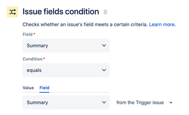

  4. Issue field condition (inside the branch we created): Check if the summary equals the summary from the trigger issue. This is because JQL does a fuzzy search when matching words so it will include results that have the same words but they might be in a different order. So we'll remove those results now

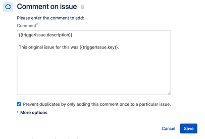

  5. Comment on issue (inside the branch we created): This will add a comment to any issue that is found in the above JQL search, so if there are multiple issues with the same reporter and summary then they will all have the comment added.
    For the comment I'd suggest {{triggerIssue.description}} this will comment whatever is written in the description of the issue that triggered the automation rule. Also if you want to link to the duplicate issue you could use {{triggerIssue.key}}.

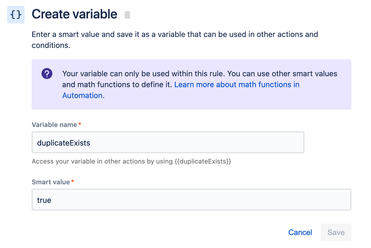

  6. Create variable (inside the branch we created): Now we want to set the variable we created earlier to "true", this is to show we found a duplicate issue in our JQL search. If no issues are found in our JQL then this will still be "null".

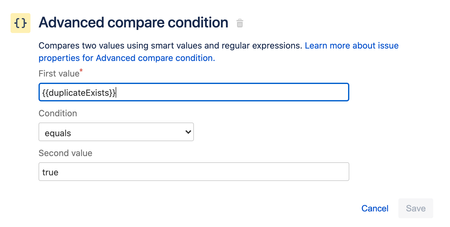

  7. Advanced compare condition (Outside the brach): This will check the variable we created and if it is true it will run continue the automation.
  8. Transition issue: this will transition the duplicate issue to done.
Let me know how you get a long. The main issues I ran into was my JQL being slightly wrong. So you might want to do a JQL search in the issue navigator first and then replace parts with smart values.
