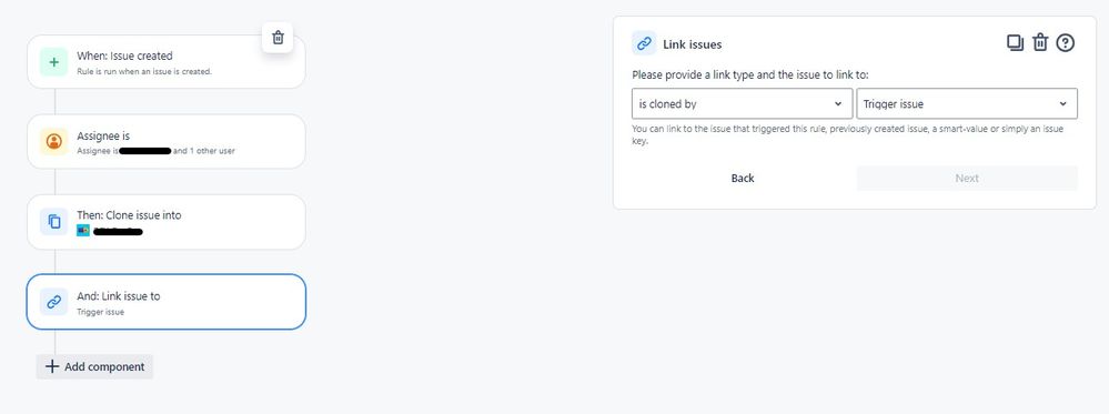

Hello, I am trying to configure a rule that automatically clones a ticket to another project, assigns the clone to the same user as the original and then links the cloned ticket back to the original. I have it working except for the last step, as it never links back to the original. Here is my automation:
From researching the other posts in this forum I have verified that the rule is scoped for multiple projects and includes both the source and destination projects in the scope.
I have also confirmed that the Link issues outlined in the last step of the automation exist in the source project (below):
The issue is automatically cloned with the proper assignee, but still does not link back to the original issue. Is there something else I'm missing?

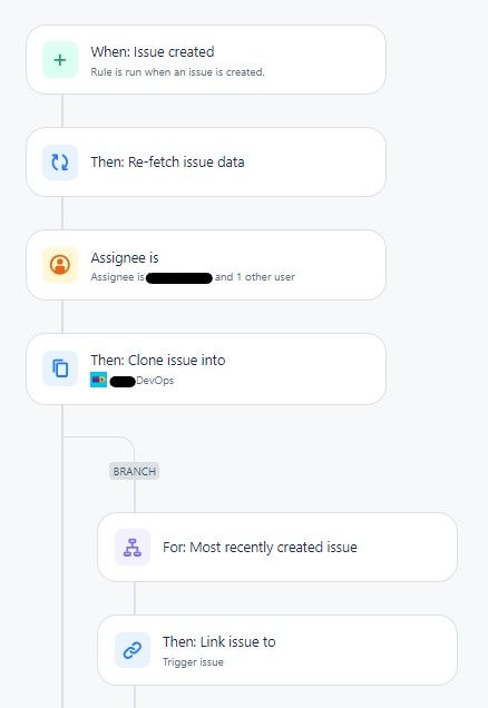

Thank you very much Bill, that solved the problem! For anyone else who may benefit, here is the final automation:

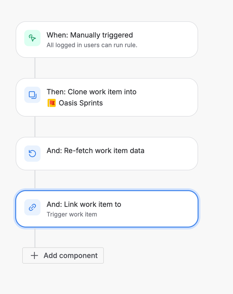

Carey Aydelotte
April 16, 2026
I had the same problem. Here's my solution:
1) Clone work item
2) Re-fetch work item data
3) Link work item to trigger work item
Mine is a global automation, which requires a Jira administrator to set up. It had to be a global automation because the original ticket (or trigger work item) is in a different space than the new ticket.
