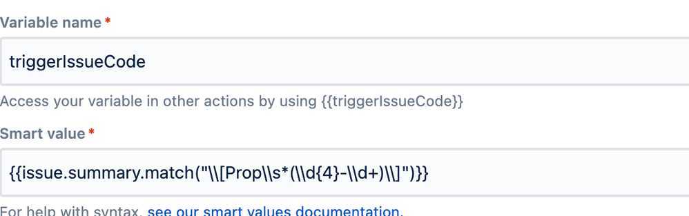

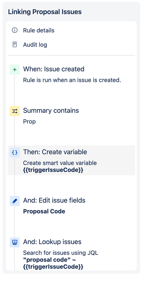

Screen Shot 2023-08-17 at 8.23.32 AM.pngScreen Shot 2023-08-17 at 8.21.20 AM.png
Here is a screenshot of the automation I ended up with. Basically, I used ChatGPT to give me the smart value that will extract the code from the summary and save it to a variable. That variable goes into a custom field and the issues that have matching values for that custom field are linked.
