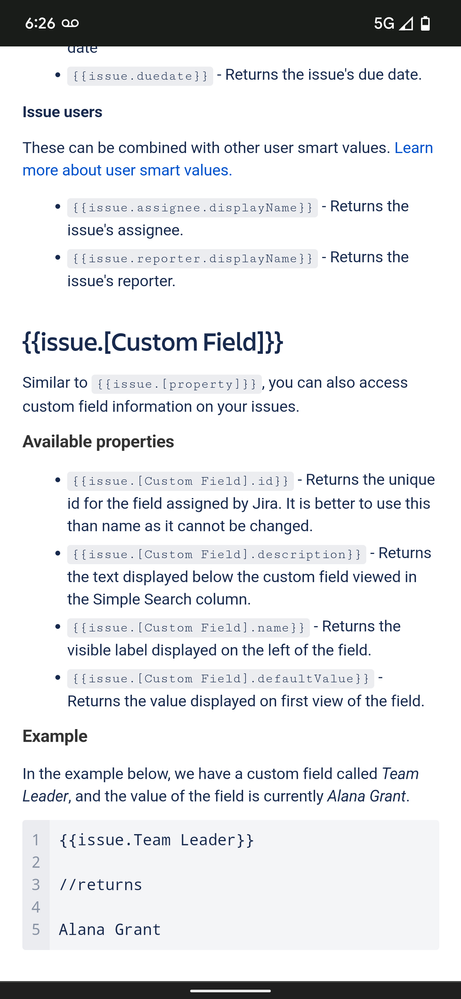

I have been using this as a resource to see what my options are:
https://support.atlassian.com/cloud-automation/docs/jira-smart-values-issues/
Available properties
{{issue.[Custom Field].id}} - Returns the unique id for the field assigned by Jira. It is better to use this than name as it cannot be changed.
{{issue.[Custom Field].description}} - Returns the text displayed below the custom field viewed in the Simple Search column.
{{issue.[Custom Field].name}} - Returns the visible label displayed on the left of the field.

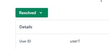

Here is my custom field information:

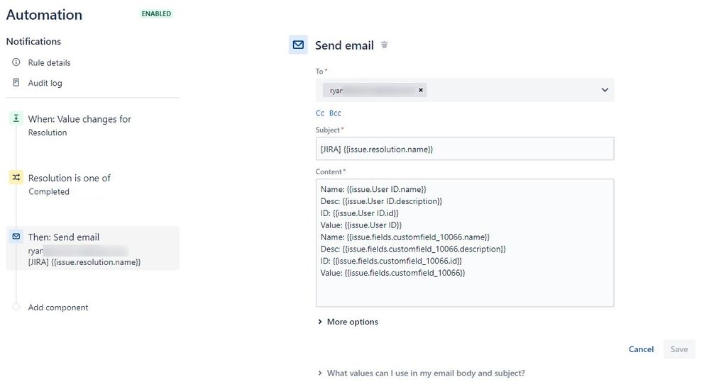

This is my automation content:
Name: {{issue.User ID.name}}
Desc: {{issue.User ID.description}}
Value: {{issue.User ID}}
Desc: {{issue.fields.customfield_10066.description}}
Value: {{issue.fields.customfield_10066}}

Ryan, would you please post images of your complete automation rule and of the audit log details showing an execution that does not work as you expect? That may provide context for why the data is not returning. Thanks!
Sure, thanks for any insight. I thought it was pretty straight forward in the documentation, which is why I just dont understand why I am not getting all the data I expect. This is a test rule I created just to play with the data I can pull.

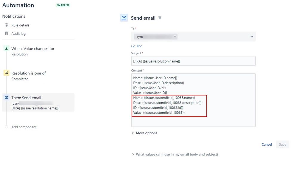

Bro, take the "fields" part off your smart values. So in your case it would be {{issue.customfield_1066.id}}
Here is the updated content per your suggestion.
Keep in mind, I have no issues pulling the values from the fields in any of the syntax examples I have tried, I am unable to pull the field properties. I was assuming based on the published documentation I provided in my original post that these properties were available in the manner they are being requested.
Thank you for the reply, but I tried your suggestion and it resulted in the same data output as the examples I provided. I can pull the value in each iteration of the syntax, I just can't seem to pull the properties of the custom field.
