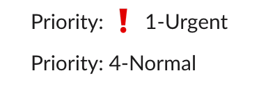

Priority: {{#if(equals(issue.priority.name,"1-Urgent"))}}:exclamation: {{/}}{{issue.priority.name}}
which produces in Slack, in our environment:

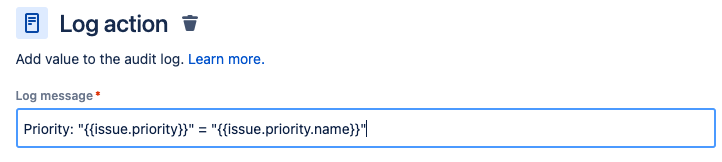

In our case, the internal priority numbers don't always match the prefixes used for priority names, as illustrated below. So I'd probably use priority.name in our rules for maximum clarity. Note how helpful it was to use the Audit Log action to confirm the actual values for the priority field:
